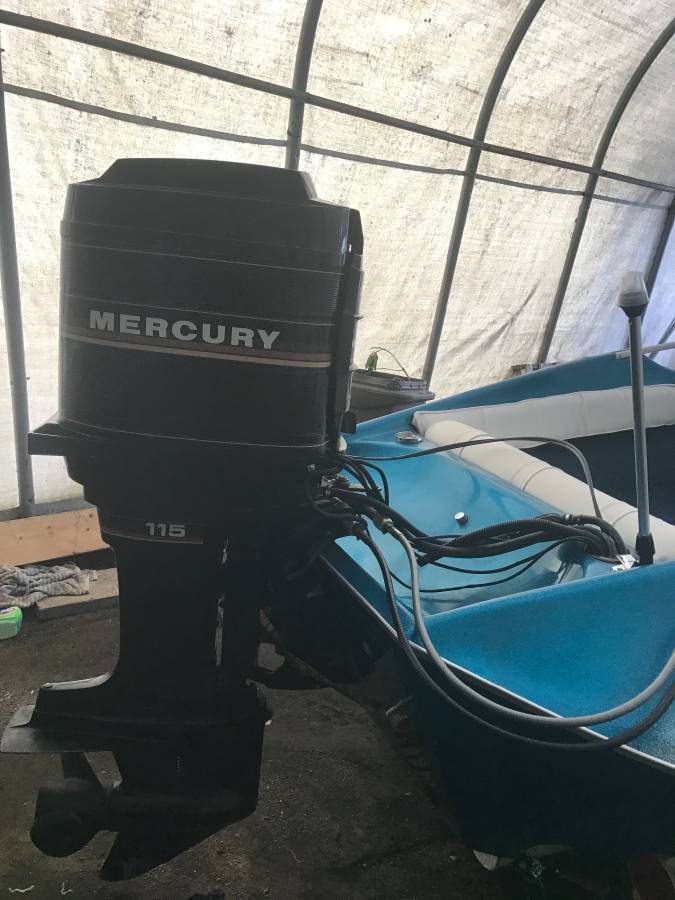

Once the seats have been fitted and measured i took everything back out and prepped the floor for black gel coat. i chose to do this because it just adds an extra layer of protection. the floor all they way back to the transom was covered in gel coat. the area were i have been doing all of fiberglass and wood work was now a mess and everything i touched i had fiberglass on it. so i decided to bring it out in the sun, and work out side because it was now May 2017.
Mounting the engine was my next big project. Luckily i used the same holes as Hydrostream. i purchased a stainless steel plate for the motor to sit on. The mirror finish is more for looks, why not right. The hardest part was drilling stainless!! Too many bits were destroyed. But it mounted and fit like a champ.
The boat looked like it had really bad oxidization on it, but what had me thinking it was possible to buff it out was when the boat was wet it looked brand new. so my next project was to buff the entire boat. once the boat was buffed it was time to start the dash panel, mount the trim unit, put bass tank in, etc...
