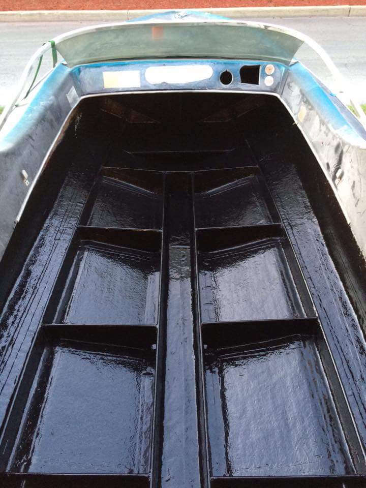

Re: 83 V-King (Bruiser) Restoration
You are correct, there is no core under them in a vking. A Vector and Viper there is.
As for no core, I know of two boats that were built with no core, one of them is not yet finished, and the other one took a pounding. They ares laid up pretty thick though.
This Beekids Vector with no core.
Ill dig up some pictures of Dans vector he is building with no core in a bit.

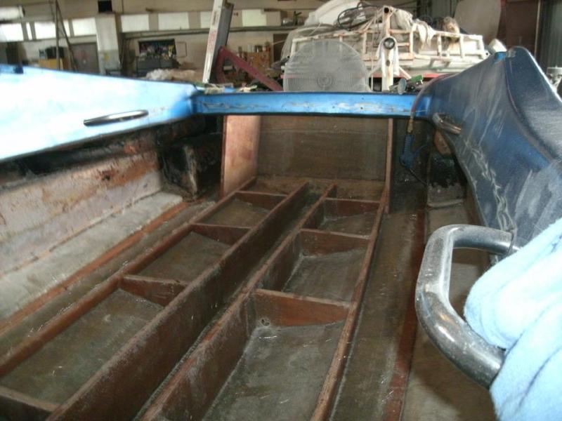

Found it, here is a picture of Dan Bulgers vector with no core. He is also not going to be running a floor and having an open stringer set up. Being built as a center steer drag boat.
He did however leave his float boxes in and in his Vector there is core under them. Weather its good or not we dont know but he is leaving em as he did a few samples of the foam and found them to be dry so he decided to leave em.
