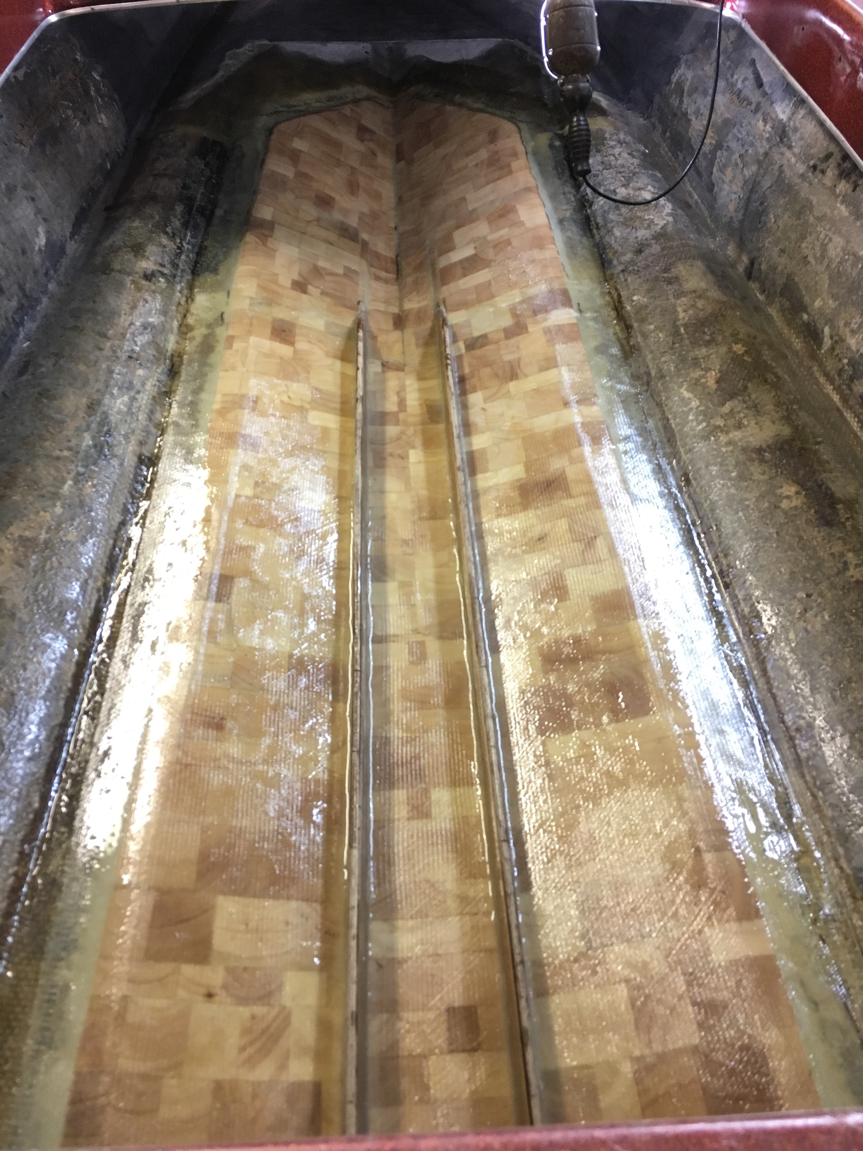

Ive been doing a full restoration a 1978 Vandal. I had absolutly no experience in boat fiberglass before i started. I have to say i think i will be much smarter at buying boats from this.
I have to thank the internet for the guidance, and knowledge. I thought i would post here, and ask some questions.

Some one was in to it before me and made stringers out of string! (Yellow rope)
Im just dumping pics.

The transom was never broken, and the splashwell areas in decent shape. I decided not to cut the top skin off the transom because the skin on the back was very thin. Pictures speak...

And here is where im at now. Grinding out a million blisters and gonna try to straighten out the bottom the best i can. The "hook" in the pad is not as bad as before re coring. I suspended the shell on three points while working inside.
The rest of the bottom, besides blisters and nics is pretty straight.

I decided to grind em out. Its gonna be awhile! I dont have access to a gelciat peeler, or i would remove all the running surface gel.
After filling i think i will lay a 4 oz over it all before adding for fairing/straightening.

Pandemic progress! It’s on year 4 of being in the shop as a side project. It will be getting wet next summer. Very nice to see the end in sight.
