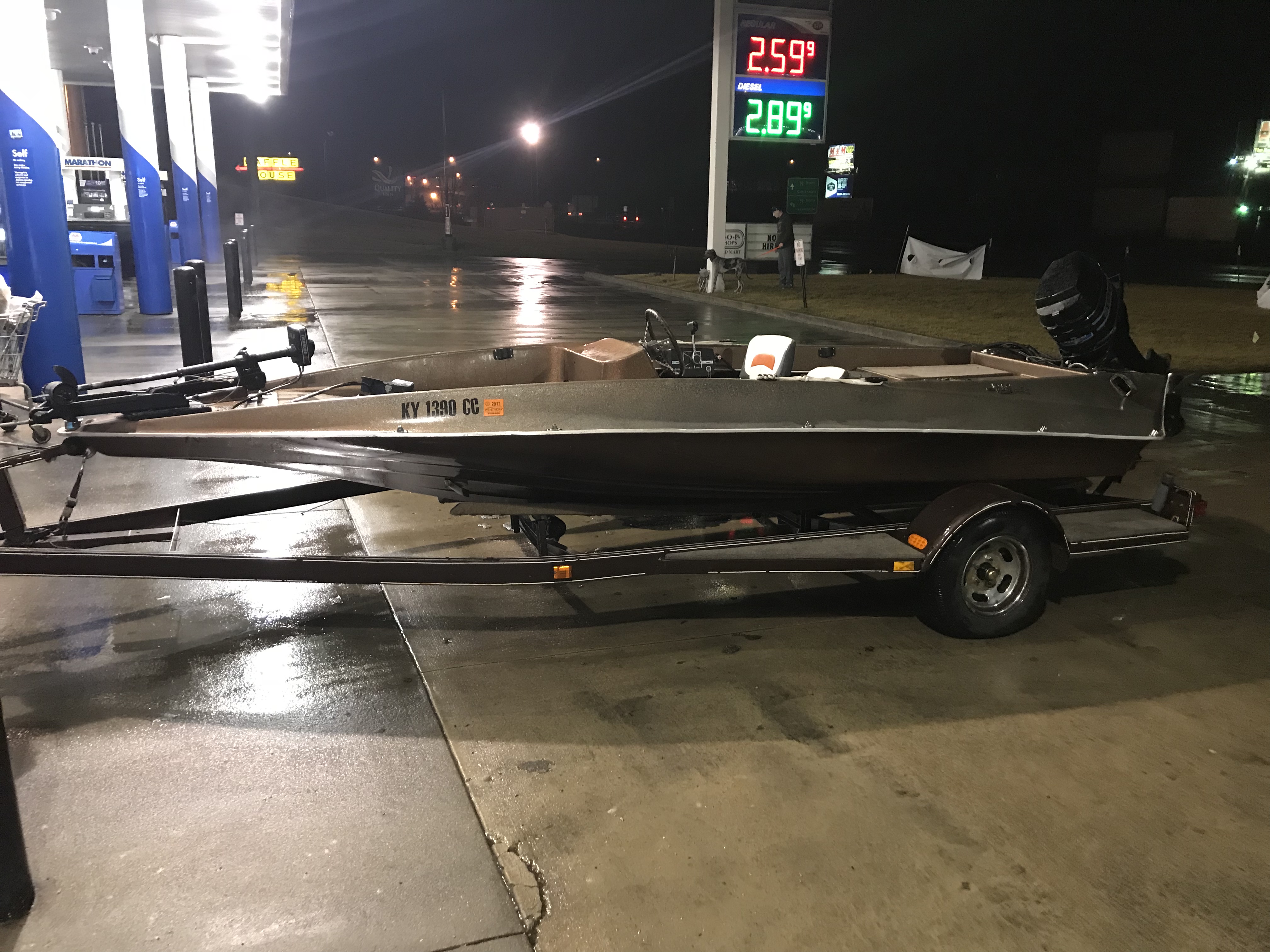

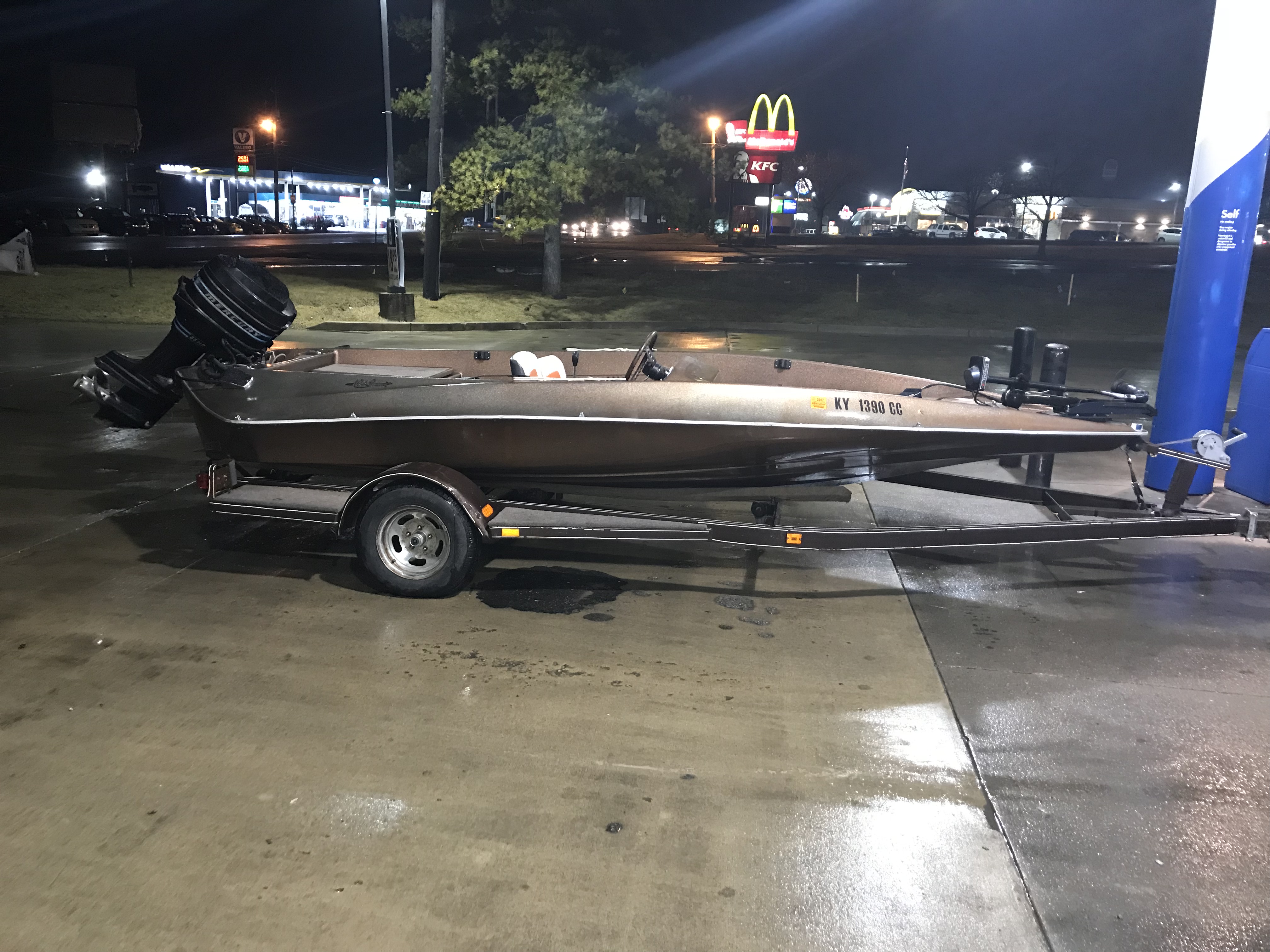

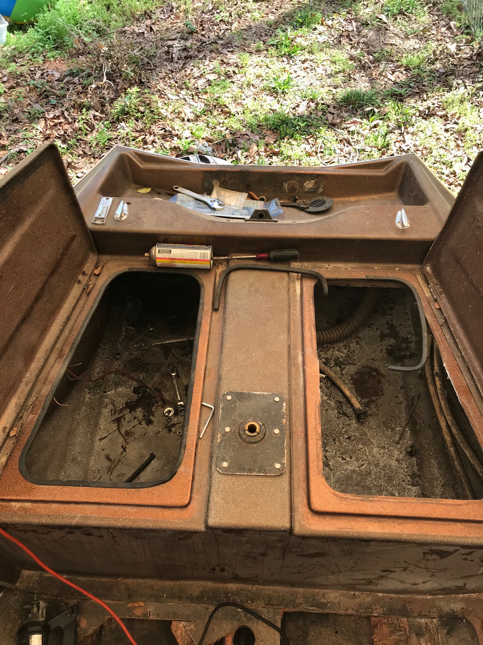

Here’s a few. Just started tearing into the floor and getting ready to do the core.

That’s not a comp hull is it? Or did you cut out the rear livewell? Plans to split it?
Looking forward to more progress pics, I have an ‘81 Varmint!
Edit: I saw on Facebook he cut the rear livewell out. Not a comp...

I cut the aft livewell out to get access to the floor. Every bit of wood is rotten. I’m glad I dig into the transom, it was worse than I thought.
I’m not going to split the hull, I’ll piece the splash well back together and paint the top cap at a later date.
Alaskastreamin, I’m glad I saw where you mentioned vinyl ester doesn’t cure in thin layers, that potentially saved me from grinding out new core.
