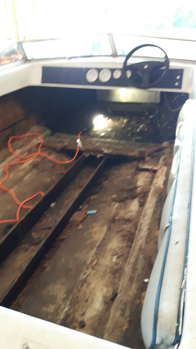

Just saved a 1985 Valero V bottom in some serious need of love. The boat has been butchered with layers of paint on the top half. The original floor was rotten so the guy just screwed 3/4" sheets of plywood down over top and 2 of the deck screwed went right through the bottom of the boat near the sides and they cover the plywood in a fake wood rubber flooring.

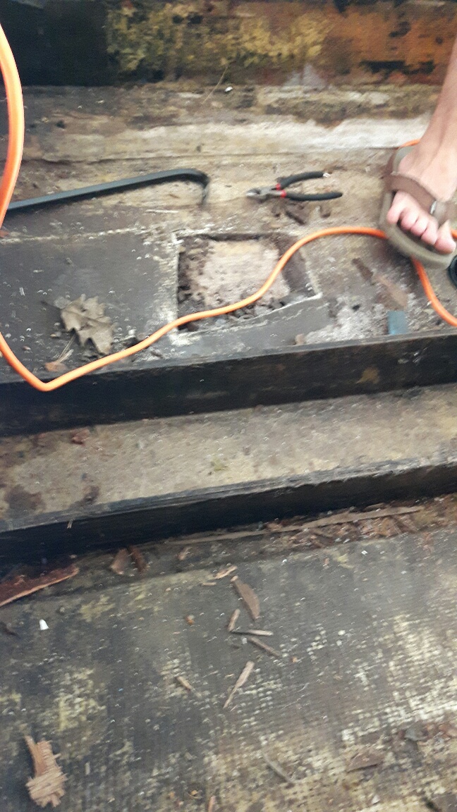

I got all the rotten floor out and cut a square of glass out of the bottom and the core is like wet cardboard. Stringers are rotten too.
So who knows about these valeros? From what I gather they have the same bottom as the Viking?
Is there also a core in the pad area between the stringers?

Hi.. . Im new to the site and just bought a Valero.. I am looking at doing the cord just wanting to know what it the thickness of the core is in the bottom and sides of the hull.

Typical balsa core thickness is 1/2". Yes, the Valero hull is the same as the VKing. Just the top deck is different.
