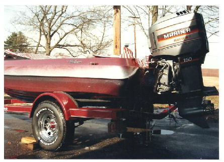

probably going to need core and new transom....theres a crack/chip on top of the transom.and water been getting in there all these years........Russ

well I'd say its need a core and transom.that's why I didn't buy the boat again....couldn't agree on a price with that being needed...most people look at the outside of the boat and say its fine........the stress cracks have been there from when I owned it and the chip on top of the transom too.never had any bottom damage when I owned it..it needs a core and transom which hold the boat together..I sure wouldn't take my family for a boat ride that's for sure.and wear a good life jacket when you go even by yourself..........I really wanted that boat back I'm the original owner.but like I said I thought the price was too much for what it needs
