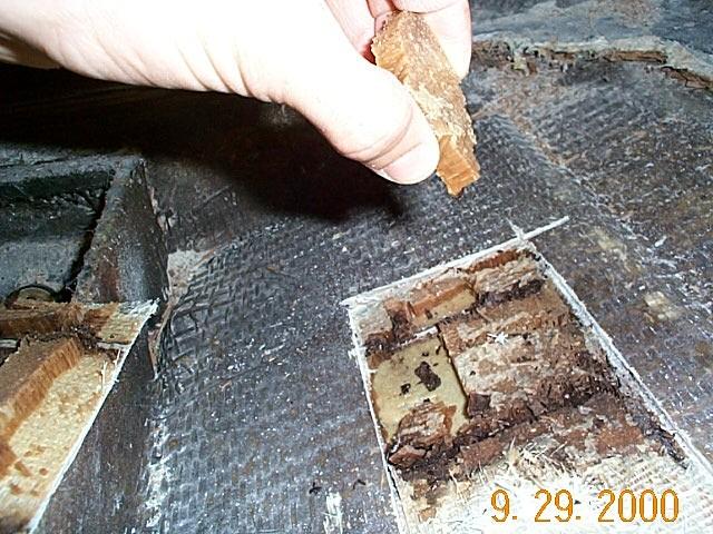

Re: 82 Vector Restoration
I removed the floor and cut a section into the core to see if there was water. I did find the balsa wood had some water in the back part of the boat. You could tell just by looking at it because the color was much darker than the areas without water damage. I attached a picture of the part of the core I took out. I haven't done much else on the boat since due to time constraints and lack of expertise on my side. Good luck with your restoration! Sorry if I'm not very helpful to you. It sounds like you are about at the stage I left off at.
- Core in bottom of boat
