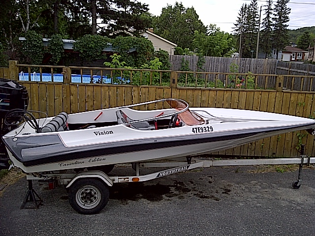

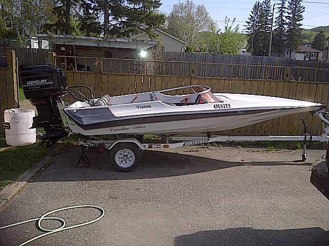

Jackplate
Jackplate
No Jackplate
No Jackplate

Fly N By, post a picture of where your motor is bolted to the transom, not close up, wide enough to see the engine as well. We'll be able to let you know what you have without all the guessing.
