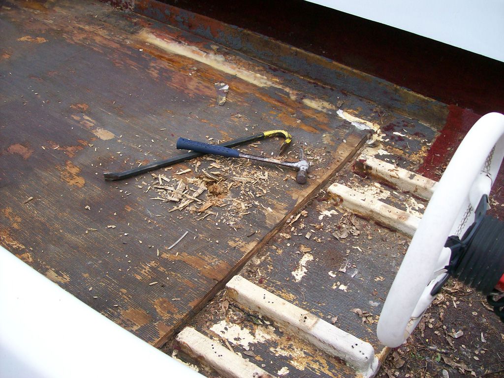

How did you attach your seats to the seat box bases there? Is you can kind of see, mine wete just screwed down and while it held good it let water in around the screws and got the wood nice and wet.ccrick wrote:Well, here it is. Motor this weekend. Couldn't do anything to it over labor day due to family re-union/camping trip.
Getting close!
Rick![]()
Just trying to think of ideas on how to attach my seats again when the time comes. I am going to mount em on the floor again basically just like they were. I just want to make sure I do it the best way possible. I like sitting nice and low. Doesnt help I am over 6' tall too so its makes it nice.
- Posts: 679
- Joined: Apr 07, 2009 8:07 pm
- Location: Sterling Heights Mi.
Re: Viking recore
I glassed them to the floor before I laminated over the floor. It was easy. Stay away from screws as much as possible. Easy way for water to saturate the floor. My trim pump and gas tank are held in place by stainless carrage bolts. I counter bored on the back side of the floor and sunk the bolts into thickened resin and covered them with more thickened resin. Worked great. Only srews used were the battery tray and rear seat hinges. I sealed those off with 5200.
The seat pedisals I think are only 4" tall. The original ones were still some what intact so I just used those dimensions.
I don't think thats how the floor was originally. Should be like mine but longer. One piece from the transom to the bulkhead. Well, yours will have to have a seam in it. My floor was exactly 8' long.
