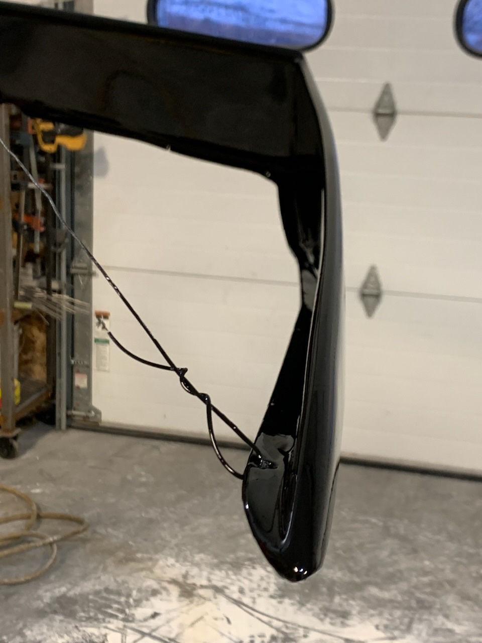

Got the windscreen detail sanding done, black gel and since it was looking good, the sun shield clear top coat was sprayed on.

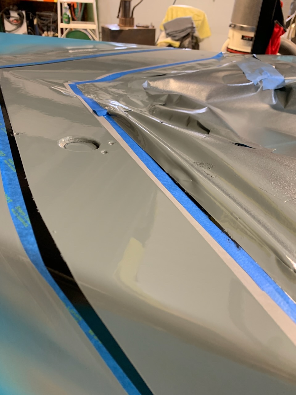

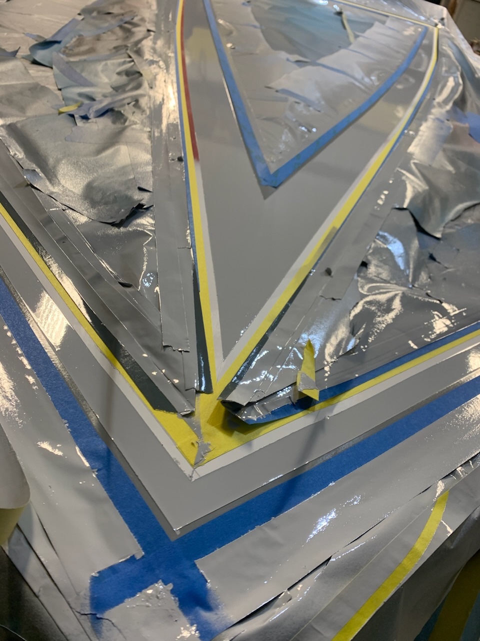

With the shop at 70*, I was able to get two colors sprayed today. Medium and light gray.
Tomorrow is the red and maybe white.

Got the red AND white on today. Done with colors!!
Wet sand flat and clear tomorrow hopefully.

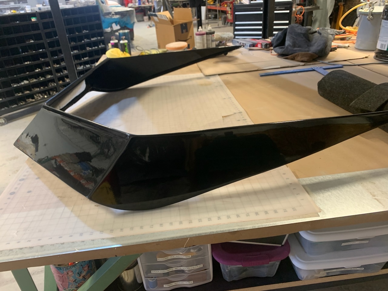

While waiting for the red to get hard, the windscreen got sanded and polished.

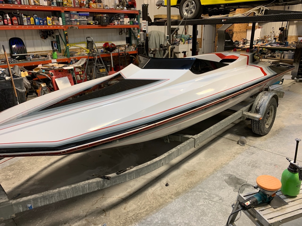

The complete boat got re-gel coated.
What a time sucker this was.
8 hours wet sanding everything flat. Three coats of sun shield clear. Looks like wet candy!!

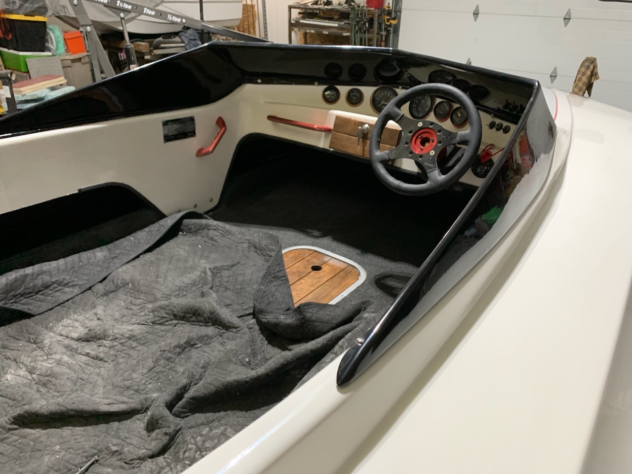

Spent Monday block sanding the deck.
Tuesday buffing and putting the dash back together, shifter, etc…

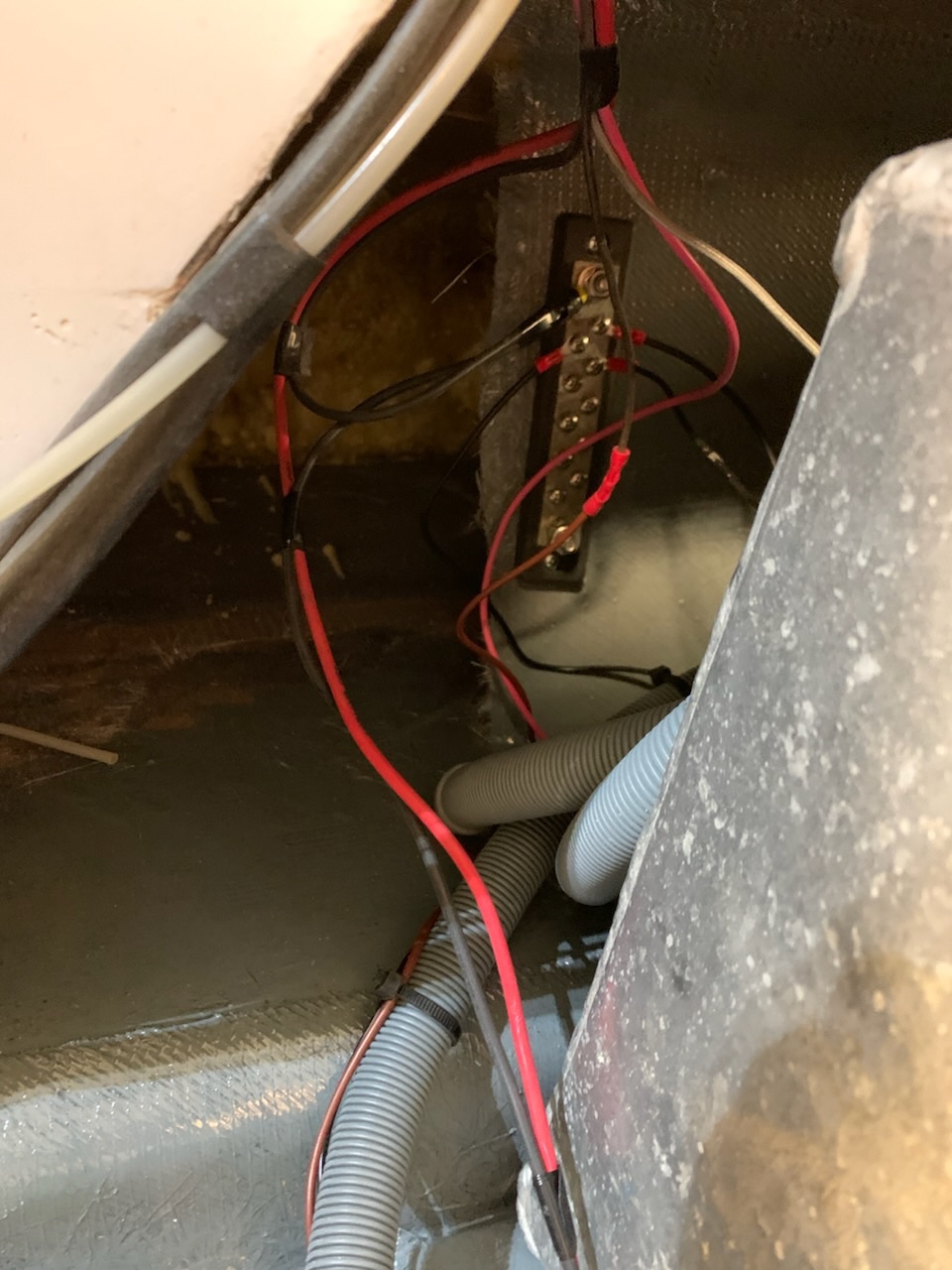

Today got the gas tank in, bilge pump installed, steering put back in, made a pro-trim style bracket for motor trim switch, battery tray, drilled holes for bilge thru hull and rigging hoses. Got the wiring cleaned up in the back. Added a terminal block for the grounds. Keeps the battery posts tidy.

Windscreen is on. Looks really good!!
Rigging continues….
