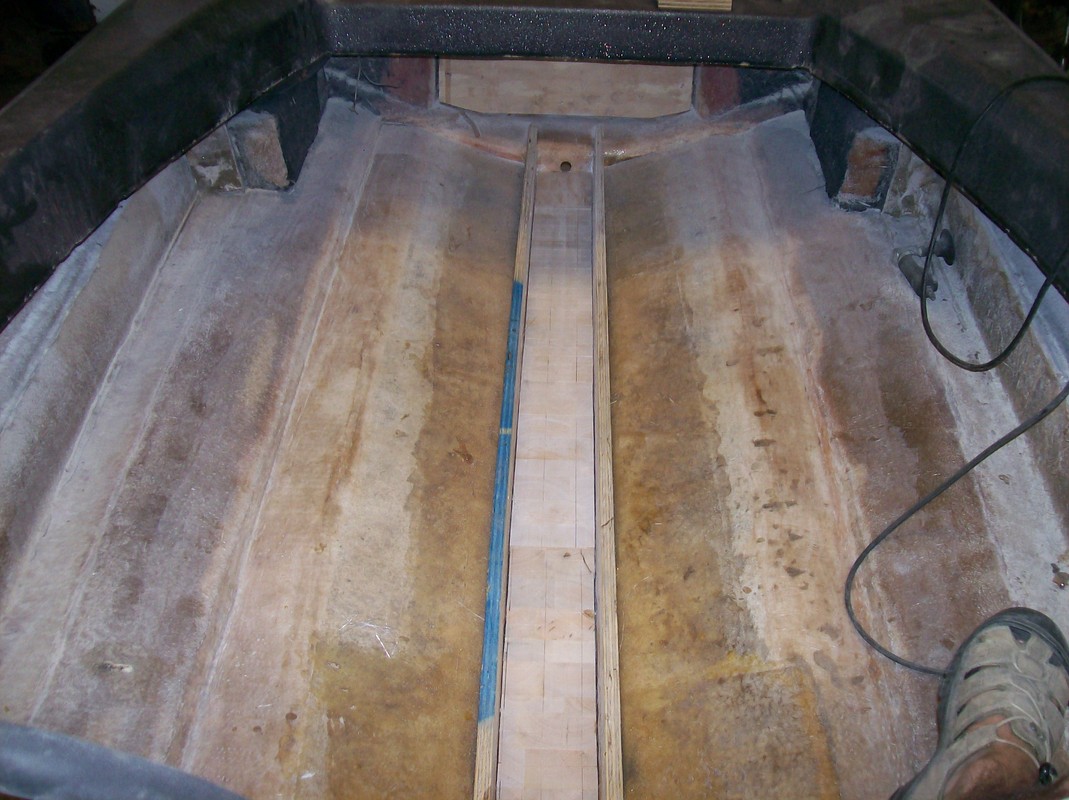

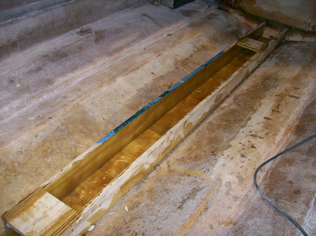

I made some more progress today, didnt get much done yesterday, had to bring my children to the Circus. Started off by dry tabbing in the inside of the stringers, then dry fitted the core,bedded them in and sealed them up.
100_0620 (Copy).JPG (193.64 KiB) Viewed 27153 times

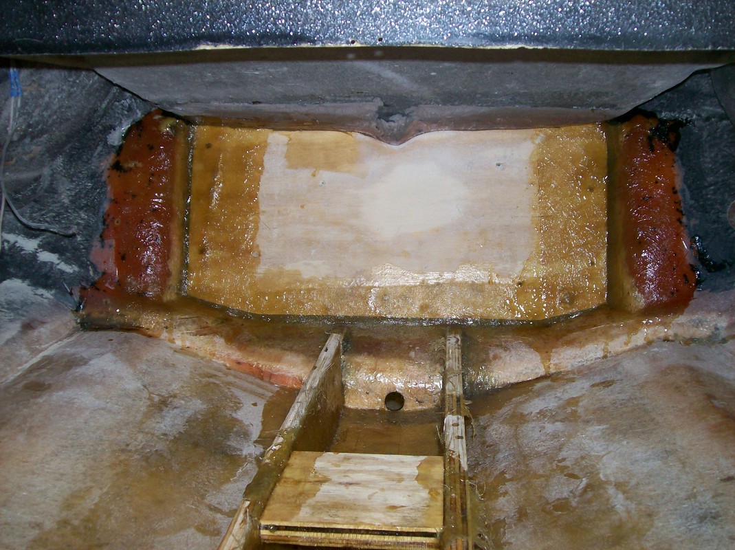

filled all voids around transom with cab-o-sil
tabbed transom
100_0621 (Copy).JPG (204.16 KiB) Viewed 27153 times
100_0623 (Copy).JPG (259.6 KiB) Viewed 27153 times
100_0622 (Copy).JPG (226.22 KiB) Viewed 27153 times
100_0624 (Copy).JPG (232.63 KiB) Viewed 27153 times
Pictures are out of order :thinking:
