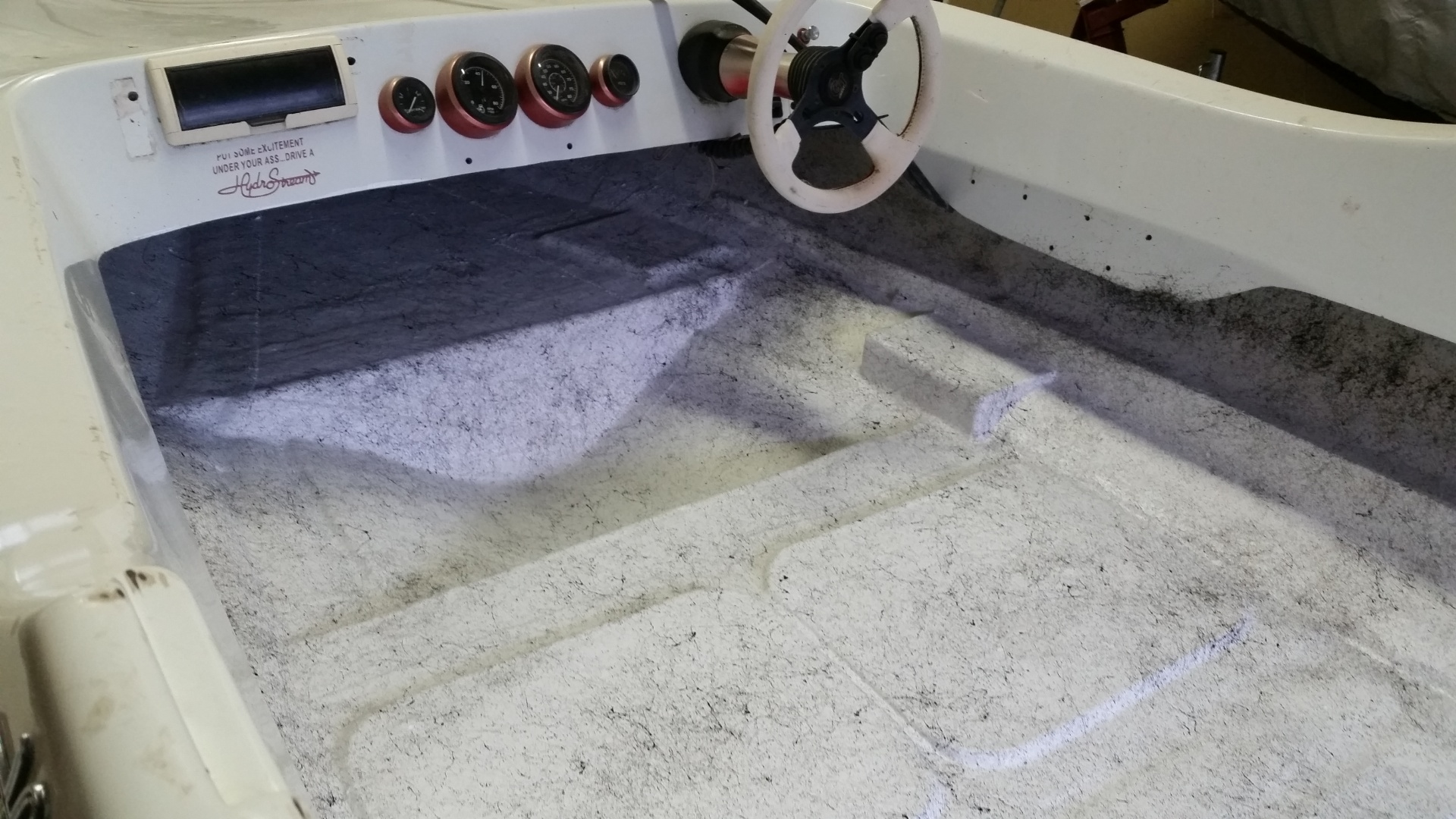

Here is how we (Brian) did the airbox in my vulture. It's all fiberglass, no wood. Plus makes for a good spot for the foot throttle mounting pad.

Huge help, that vertical face will be my main focus then i will continue with the airbox. good picture to represent the airbox. i see you went all the way down to the hull for the most leg room. little more custom design thats great. i noticed Wayy up in the bow there was a small piece of wood glassed in. you can see it in the picture. maybe an after thought Hydrostream did in 83?
Is that white Gel coat? i was thinking the same thing once the floor is in. did Hydrostream put a gel on the floor as well? more for sealant and keep water beading off more often? This is a picture of the day i picked up the stream. and there was black gel on the transom and the floor. last owner did this? If this was Hydrostream, i would like to do the same.

My 77 vulture had that little piece of wood up there too. And no hydrostream did not put gel down. Just fiberglass then carpet. I am not putting carpet back in. Went white gel with black gel spider web for a slight texture. Main reason I did not put carpet back in its carpet holds water. Plus, I can just pressure wash my interior if need be and 20 minutes under the sun and its dry.

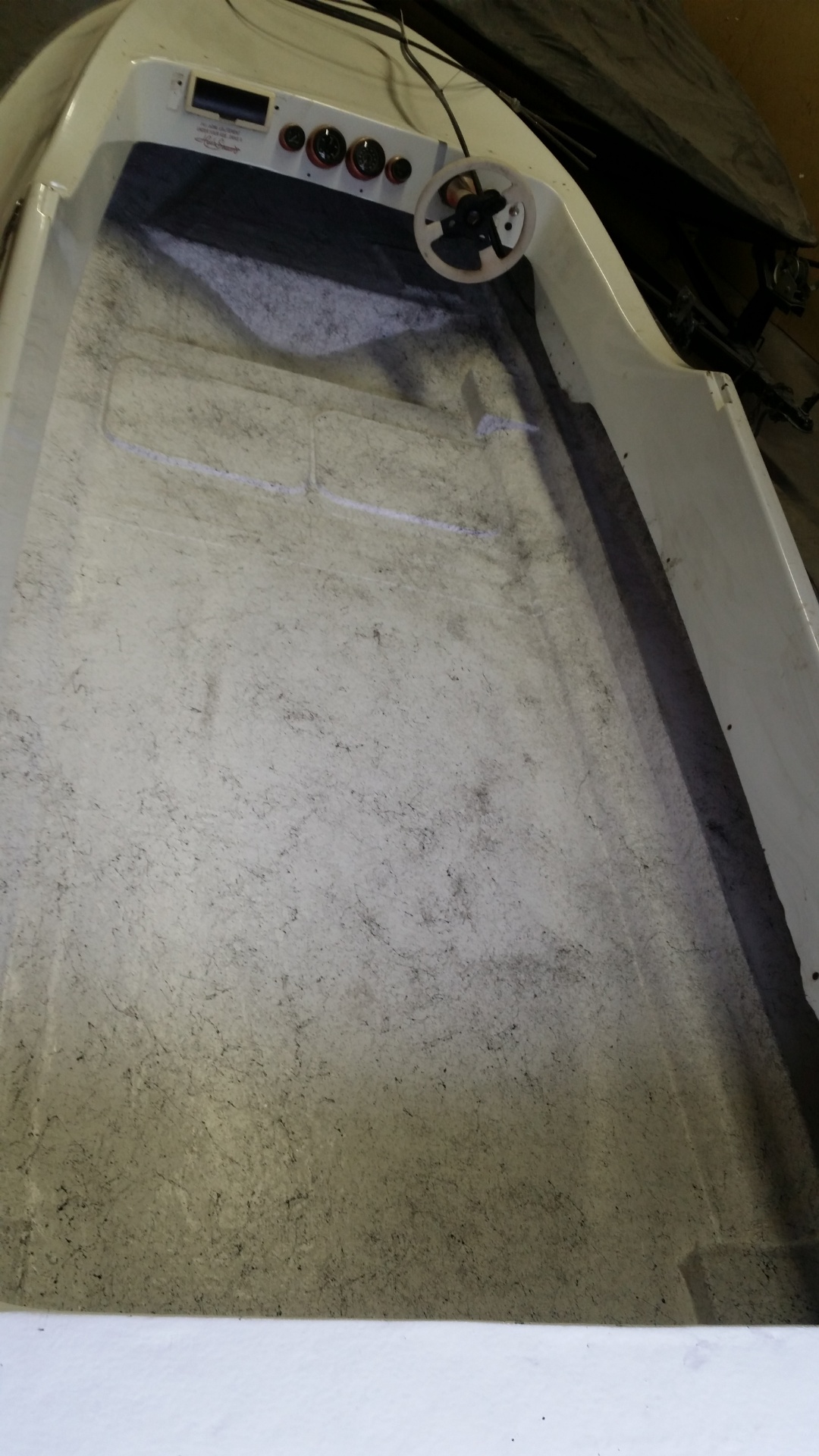

Re: 83 V-King (Bruiser) Restoration
I will start with a gallon and go from there. That floor looks solid! How much resin did you use roughly including transom.
My vulture used somewhere around 15-20 gallons of resin. The core will soak up a lot of it. I bought it in 5 gallon pails.
