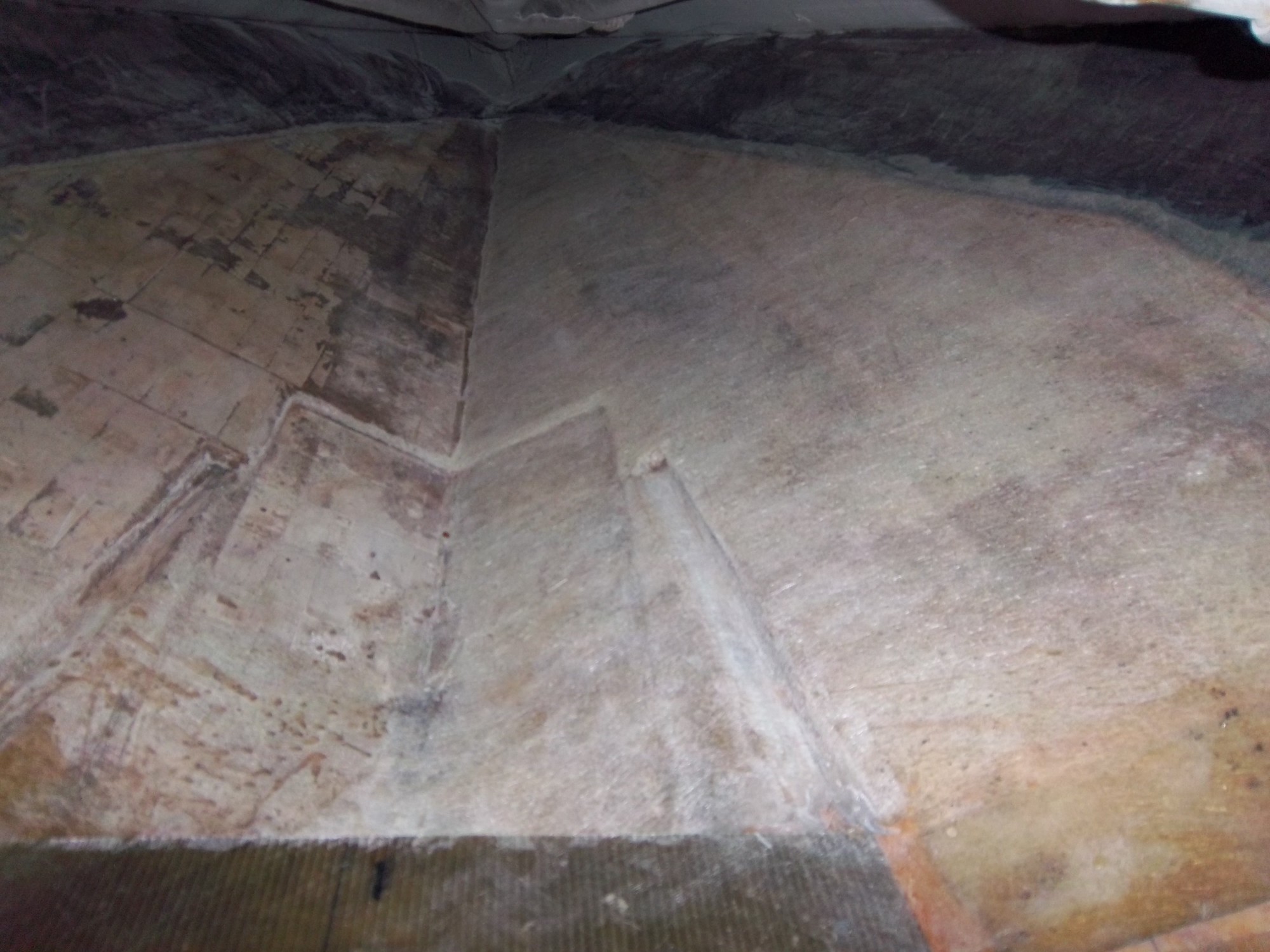

After another trip to the supply house to pick up 4 more gallons of resin I layed the 1708 over the other side of balsa. Now I am looking at the dark hole that needs grinding, I am itching just thinking about it.
100_0857 (Copy).JPG (590.25 KiB) Viewed 7826 times
Looks like time to get new tyvek suit and 36 grit disk.
Re: 76 vector restore
Post: # 15643Post VultureNo2 »
Looks great. Keep it up. Did you get enough resin up in the bow? that looks a little light which makes me wonder if it is stuck down properly or has some air pockets in it. Not saying it's wrong. Just though it looks an awful lot like the part I did and had to pull off and re-do. I ended up going through a lot more resin then I thought I would also. Bill

VultureNo2 wrote:Looks great. Keep it up. Did you get enough resin up in the bow? that looks a little light which makes me wonder if it is stuck down properly or has some air pockets in it. Not saying it's wrong. Just though it looks an awful lot like the part I did and had to pull off and re-do. I ended up going through a lot more resin then I thought I would also. Bill
No resin yet, havn't finished grinding. Just got back from lowes with new tyvec suit and 36 grit disk. Now I can have some fun.

2 hours of grinding and enough for today.
100_0858 (Copy).JPG (466.35 KiB) Viewed 7809 times
