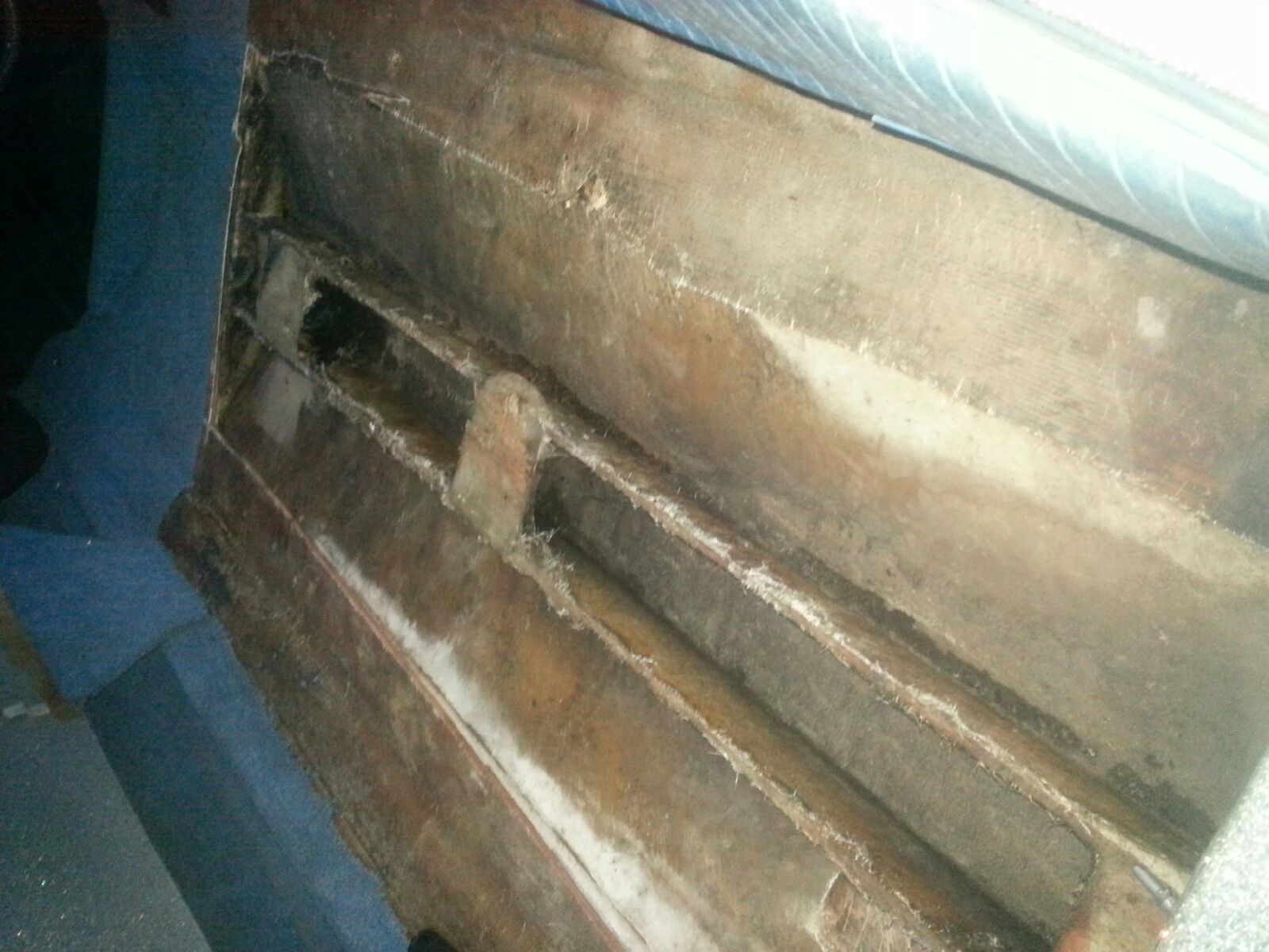

Why do they use little squares instead of one solid sheet for the cores. ?

Is that the width of the core. Right up to the floor?

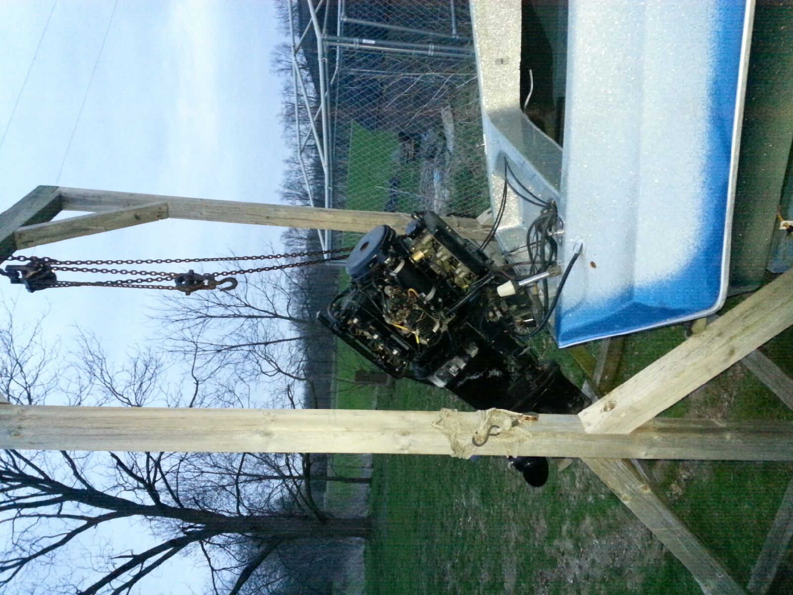

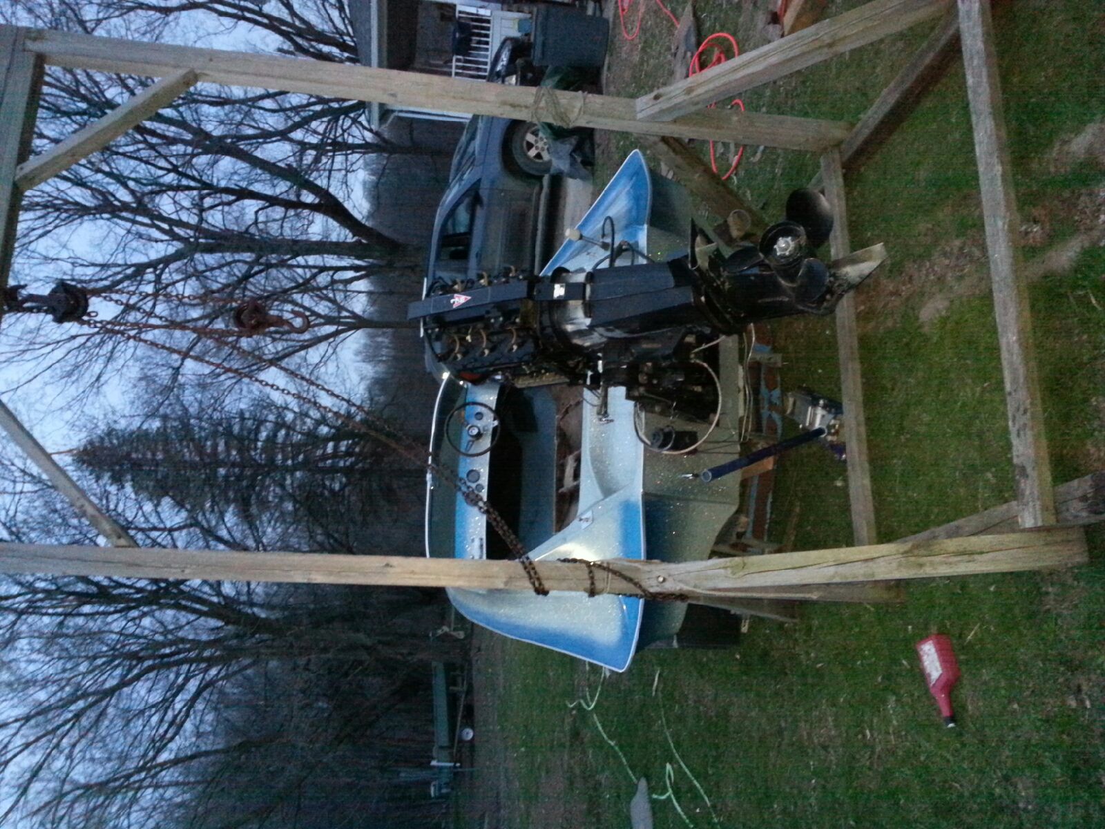

Anybody thinks this is stupid :o please let me know before I do it. I can't see a better way there is no lift holes or rings to hook to. I am going to wrap a lift strap around it and pull.

Did you pull it off already? I made my own bracket. Instead of the Mercury lift sleeve that screws into the flywheel I took 4 bolts out and made a bracket to lift it

Oh thanks I didn't want to wrap a strap around it and break stuff. I will make one

I didn't know if I should lift on the flywheel I wouldn't have even tried thanks again. Dlord111 :boating: :D

No problem! I'm glad you didn't use the strap. I don't know for sure if that would have turned out the best. I used 1/4 plate and went to the hardware store and got 4 of the flywheel bolts 1/4" longer so I had all the threads I could get without any play
