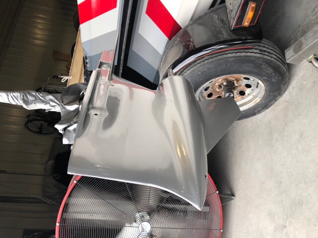

Update:
Got the interior all stitched up ( that post is in the interior forum)
I got my block back from the machine shop, bored all six to .015 over. Bought new pistons and a gasket set from ProMarine. Sent injectors off to be checked and cleaned.
It had low compression on 4&6. The injectors weren’t bad so still curious why it scored .
Hung power head, got my 1/2” pipe tap and drill bit so I could finish the nose cone plumbing. I painted the lower with some left over Dodge silver and clear coat .
Getting real close now.
My carpet is at a Phil’s place. He’s 3 hours away so I’ll get it when it’s holding me up.
Still need to assemble seat sliders & swivels and mount seats so I can position the foot throttle. Then run the engine.

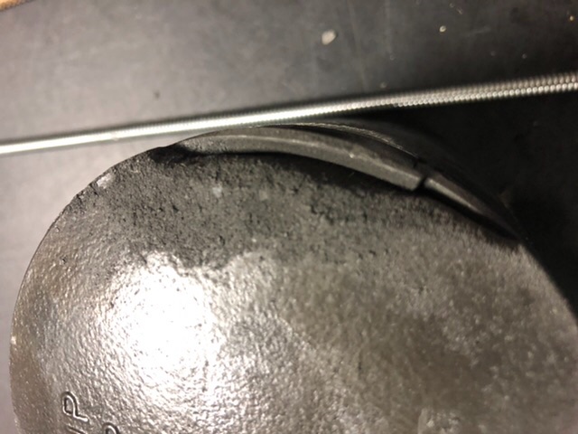

Well the first hour on the water was great. Then a little rattle so I shut her down. Pulled plugs. #6 looked dry and powdery.
Towed to launch ramp to be safe. Pulled head and #6 detonated!!
Now to figure out why. This motor has an ignition ECU and a fuel ECU. A crank sensor& throttle position sensor tell the computer where to set timing. No trigger on these.
I indexed the flywheel for all 6 cylinders marking 0* and 25*
Timing is supposed to be checked with motor running at full throttle. Well how the hell am I gonna do that? Maybe tied down on trailer at ramp-.....at night so I can see the timing light???? Most likely...
I tried it with the starter and they were all between the 0 & 25 marks.
Powerhead is broke down and at the machine shop getting a .005 hone. It was at .015 and some light scoring will come out with the hone. I’ll get a .020 piston and do some more testing..
