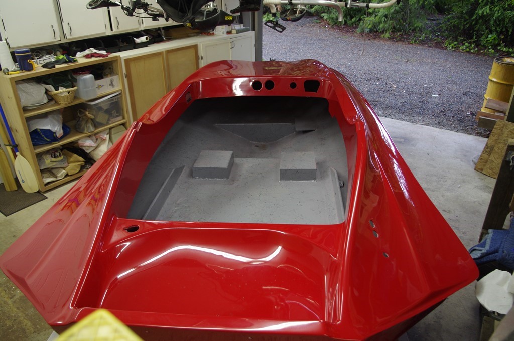

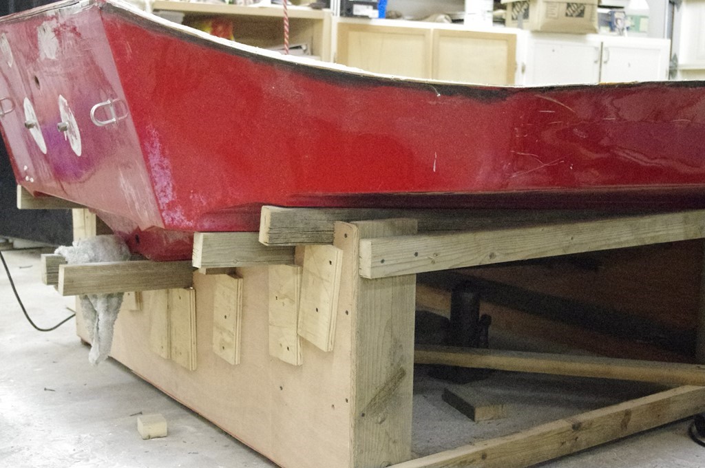

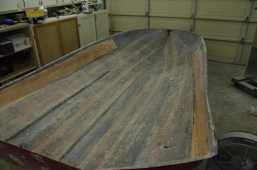

Here are the process pictures. Assembling systems now.
- _IGP1610 (Copy) (Copy).JPG (221.87 KiB) Viewed 21536 times
- new gelcoat original red

- clean shell

- cradle I made
