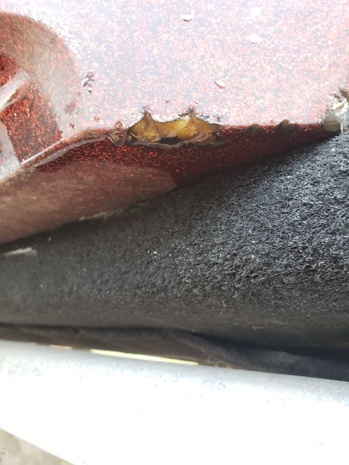

Here are some photos of the new project boat and the problem areas.

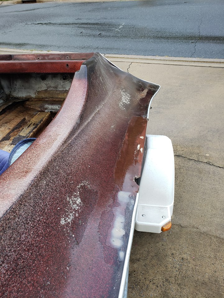

This entire section I believe to bondo, unsure of where the glass starts and the bondo ends...

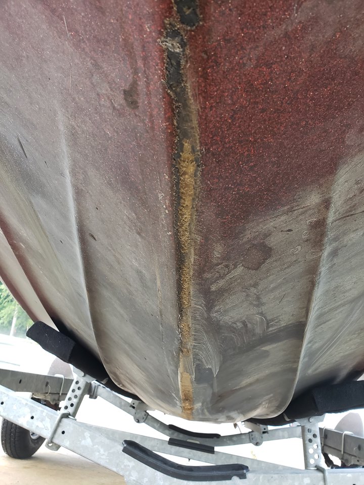

Also a lot of damage on the keel, the back corners, and the pad/hook..

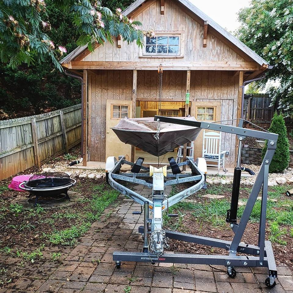

Rotating to begin building rollable jig...

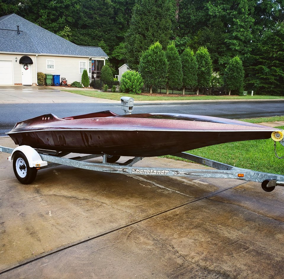

And this is our current weekend cruiser...
