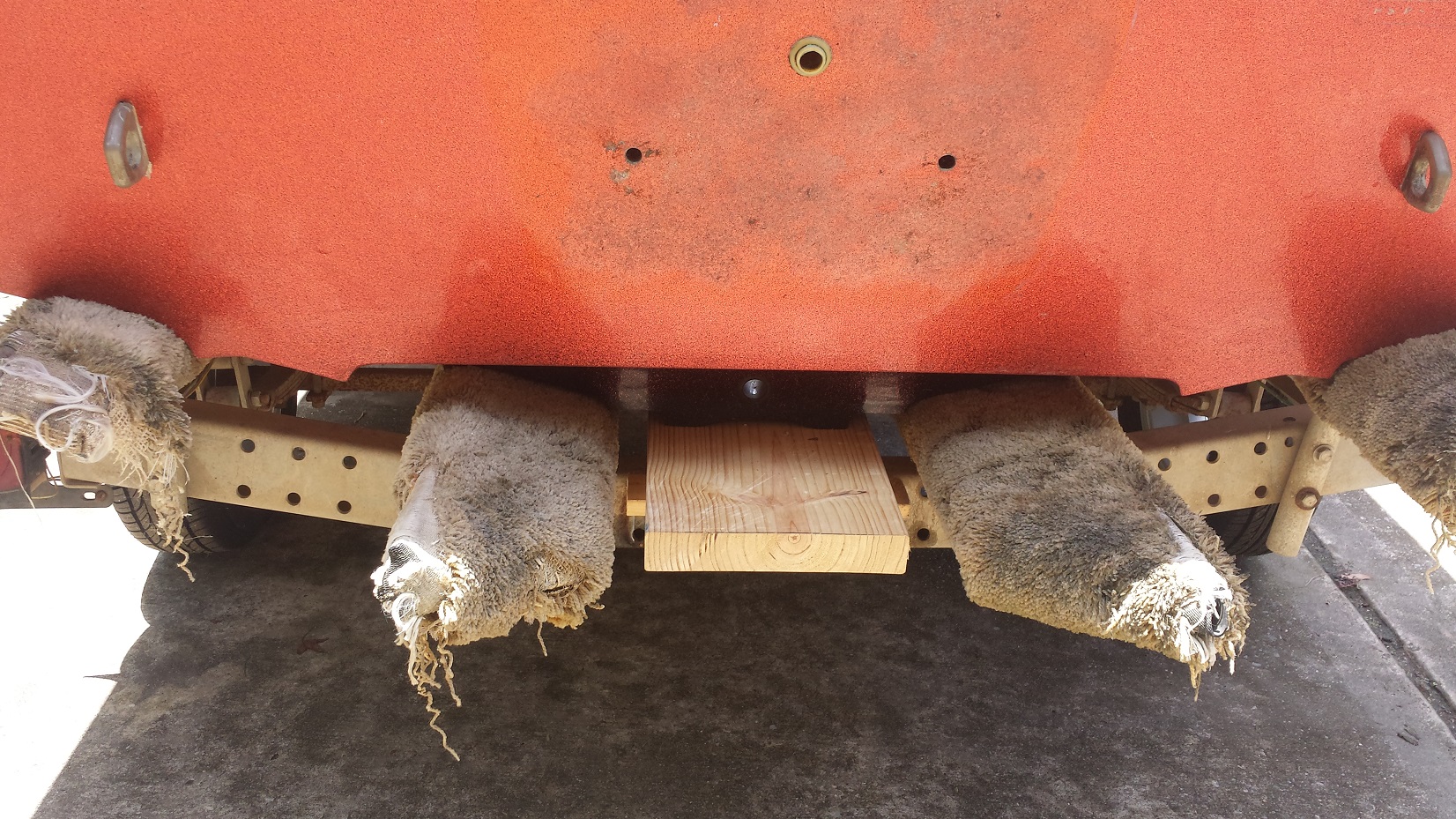

Getting started on removing core. I have a 2"X10"X10' setup under the pad, and the trailer seems to be holding things together fine, I am wondering if i need any additional support when i start getting more of the core removed?

Now you are getting somewhere. Look at all that rot. The stringers are half gone too. Take it all out until all that's left is a smooth fiberglass bottom from transom to bow. I'd do the transom at the same time. From the looks of it, it needs to be done too.
