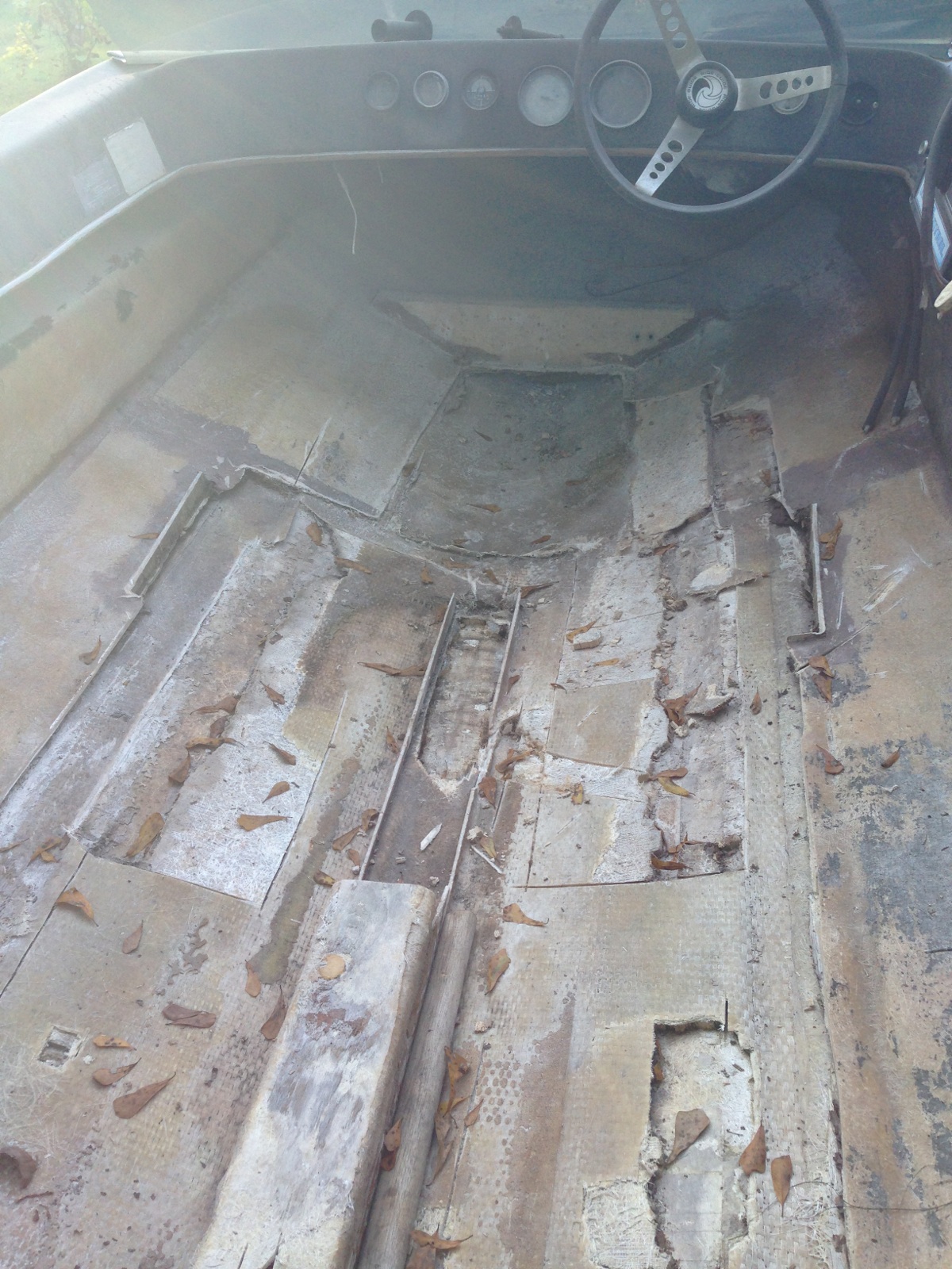

havent did much work on the boat but got out there and just cut on it a little more, havent built a jig or put anymore supports on my trailer, so i havent cut much, and trying to be carefull cause kinda confused where the core balsa stops and starts here is a picture of where i think i opened up the pad box and dug into the pad, the is the bottom skin there right?

You're doing a great job so far, keep on going carefully and you should do just fine! looks like you found the core area in the pad too. Keep it up
