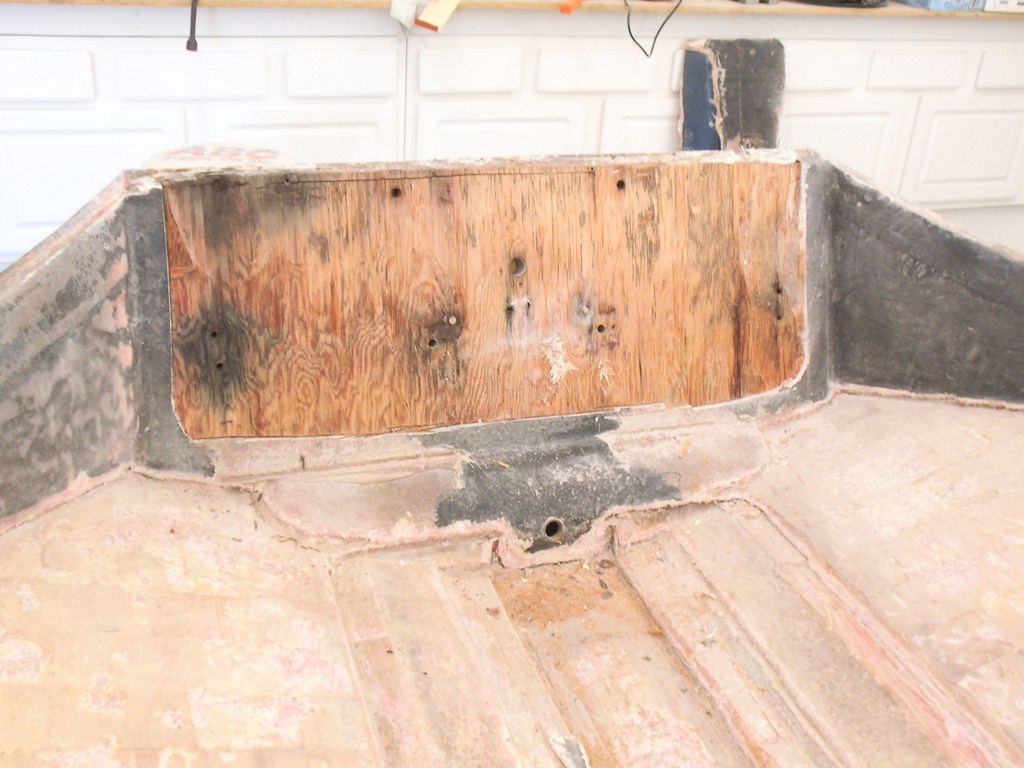

I see black wood on that transom. I would take that out as well cause if its black it is or has been really wet and needs to be replaced, and then tie your stringers into your transom with some knees. Thats just what I would do seeing you have the deck off and stuff.

Transom replacement is on deck, along with stringers tied into the transom. I have some good ideas in mind after reviewing all the other rebuild threads, on how i'm going to do the stringers.

As Hippie pointed out, the transom had plenty of wet wood. It's all out now.

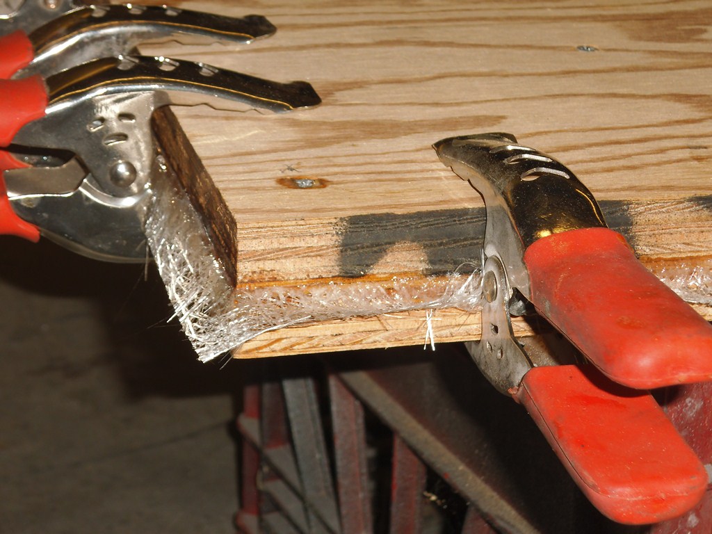

Got the transom measured, cut and glued today. Gunna start working on the stringers next
