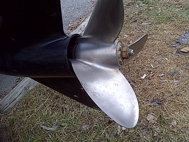

Post: # 16180Post idvette »
Well here's the 1 picture I have of it right now, I'll get more over the weekend if it's not sold.
30 pitch Merc Chopper
