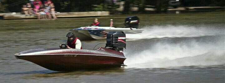

Did you loose rpm's on the top?
I will be doing some testing with a gtech here shortly and these are something I'm looking into, but if you lost rpm's on top that means they are in the water still.

Post: # 9377Post 81vector »
Doesn't look like there in the water and this is early on in the race
81 vector 2.4 225

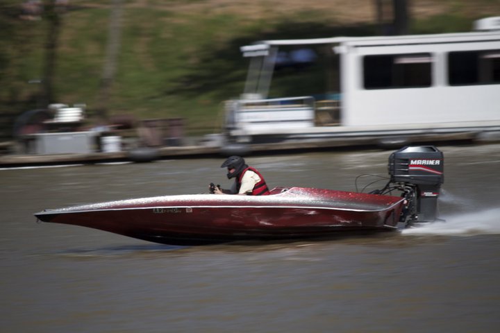

Post: # 9379Post 81vector »
Her is a picture just a little bit father along in the race than the other picture
81 vector 2.4 225
