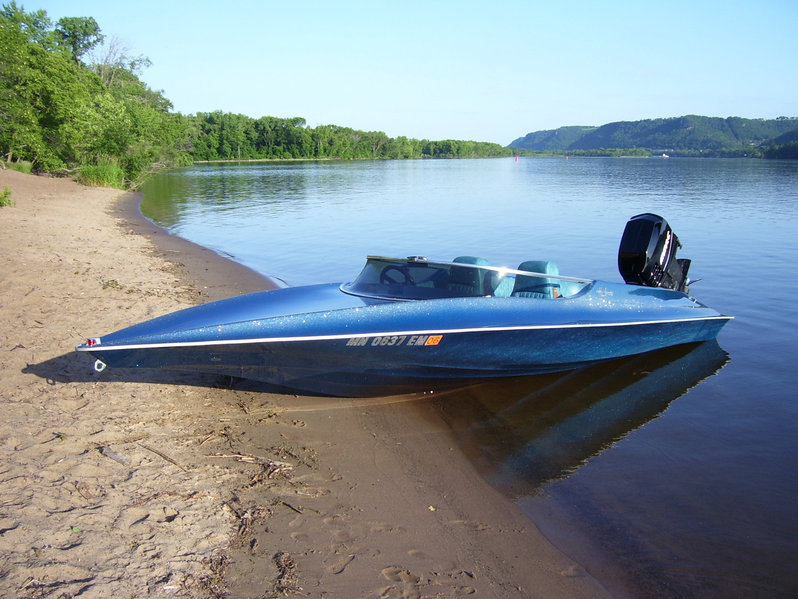

My latest project is a 1981 pad v Venus, and I seek answers to the following questions
1) Do the pad v Venus and the Vulture share the same bottom design?
2) Does any of you know any mods to these bottoms to gain performance? at a glance this hull looks to have one hell of a hook in the chines
This hull will have the floor, core and transum replaced. Its looking like I will be able to save the stock blue to silver flake finish

thanks for the reply, and I two have thought the same when looking at the pad extension/ concave area. Like you mentioned when on the pad the built into hull setback would be greater and would lessen the need for so much bracket set back, a plus when it comes to transom stress i would think. My thoughts wonder what the trade off would be in having the chines so much longer than the pad, could this promote chining?
My Venus has the same bottom as you pictured, and I to have the vacuum breakers install as you have pictured.
I am debating trying this mod you speak of, thinking that if done right, it could be returned to stock it needed. the more i consider it the more I would like to give it a try. Thanks for the input and yes the 20ft Hydrostream pad V has some really bent chines as seen on the pic of the blue vulture.

Well got into the project for a few hours, got about 75% of the foam out of the hull. Still considering the pro and cons of taking the pad extension off. 77viper and surface scratch er have brought up alot of "food for thought" no this idea that scratcher had of removing that pad extension.
IM liking this hull the more I'm getting into it. Always like the concept of the Venus and the hot boat cuddy hybrid idea. The cudddy is big enough for the recreational use that I intend to use it for, and with that hatch opened the possibilities are endless
