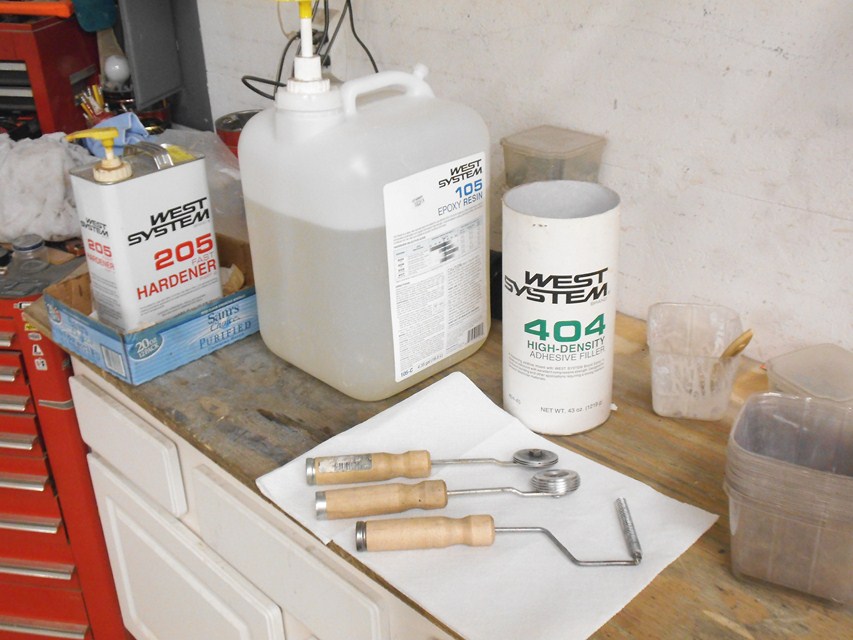

Doing a great job. Again, maybe it's the photo's, I know I am being picky, but on the side of the stringers, it looks like the glass has some air bubbles in it where it appears lighter. I had some glass over core that looked like that and realized I laid it up not wet enough and in temperatures that were a little cool. I ended up tearing some out and re-doing it. JMO. Make sure you wet the glass enough to get all that air pushed out of it and it sticks to the stringers and/or core real good. The extra resin weight is minimal so don't worry about goobing it on real good. Bill

A laminating roller is great for that. The glass should be nearly transparent when laid up.

Post: # 17247Post proprider »
Laid some more core down last nite. I think if I had a kitchen sink laying around, I would have added it to the heap of weight als..lol. My camera is just a cheap unit and doesn't take very good closeup shots. I can assure you there isn't any air left under that glass. I use a full arsenal of rolling bubble-busters to make sure all the snap, crackle and pop are all gone. Thanks for the observation.
