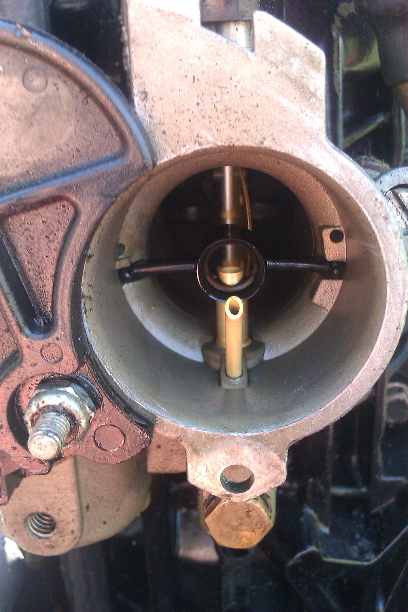

here is a pic of the middle carb at full throttle the bottom carb was turned in even more than this i dont know how far off this is im not a mechanic but i adjusted them and they are all straight open now:)

Hope to hear some good results now that your carbs are opening all the way, what size 6 you running
