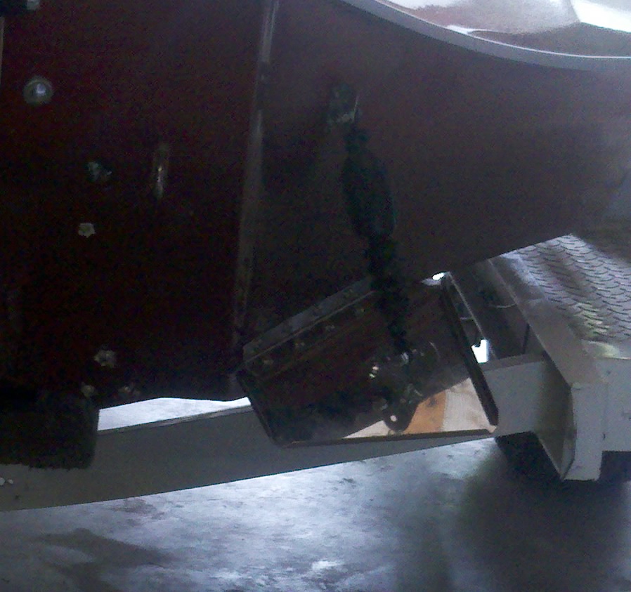

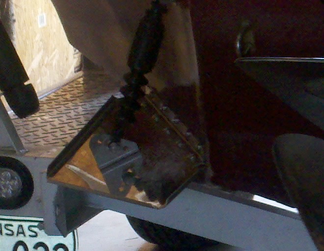

Re: tabs
Yes they are like a shock and you can lift them up and you can also change the amount of force it takes to lift them by changing to a different holes where the shock mounts to the tab that is how the mobster tabs work. With the shape of the angled tabs and having them mounted just past the transom where the hull starts to angle forward the back of the tabs line up with the transom pretty good but I would like to do more testing with mine to see where they should be placed for best performance I will try and get a better picture of how i have mine mounted I don't know if its the best place to have them mounted or not but I thought it looked like a good place to start so that's where I carefully placed them
81 vector 2.4 225
Re: tabs
A closer look
- Here is how I have my angled tabs mounted hope this helps you
- 101211212354.jpg (209.46 KiB) Viewed 9914 times

Re: tabs
Other side
- 101211214845.jpg (116.23 KiB) Viewed 9913 times

Re: tabs
dang I lust lost a post.
That is a better place to mount them than on the transom. I have only used them once in clean water and that was also the first time using a prop that I had balanced. I noticed rpm's were up 300 and speed was down 3-4mph I had thought the shop took some pitch out of it but after looking at the vid I can see the tab was causing disturbance in the water causing the prop slip to go up.
