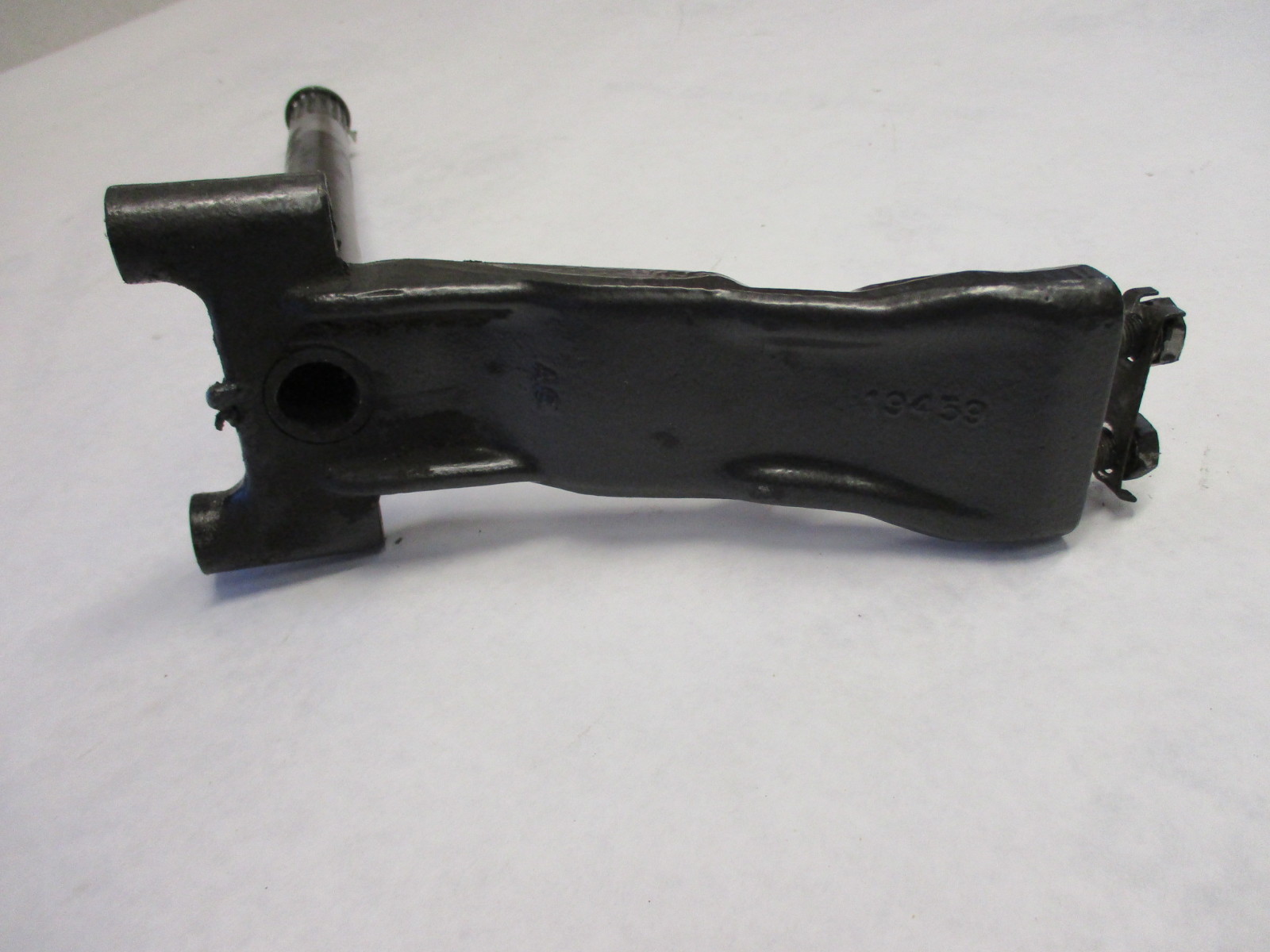

I was wondering if the two 3/8" fine threaded holes for the steering rod (cable style) was closer or further from the tilt tube thus making the hydraulic ram mount not reach.
See, with the cable set-up, this wouldn't matter as the stainless arm would pivot to find either hole. See where I was going?
Also maybe the hydraulic ram could overpower the thinner steering arm and possibly break it at full lock. maybe a liability thing. Just speculating..
Here you go.....These are for smaller motors but you can see the shape differences.
Thin Arm
Thin Arm
