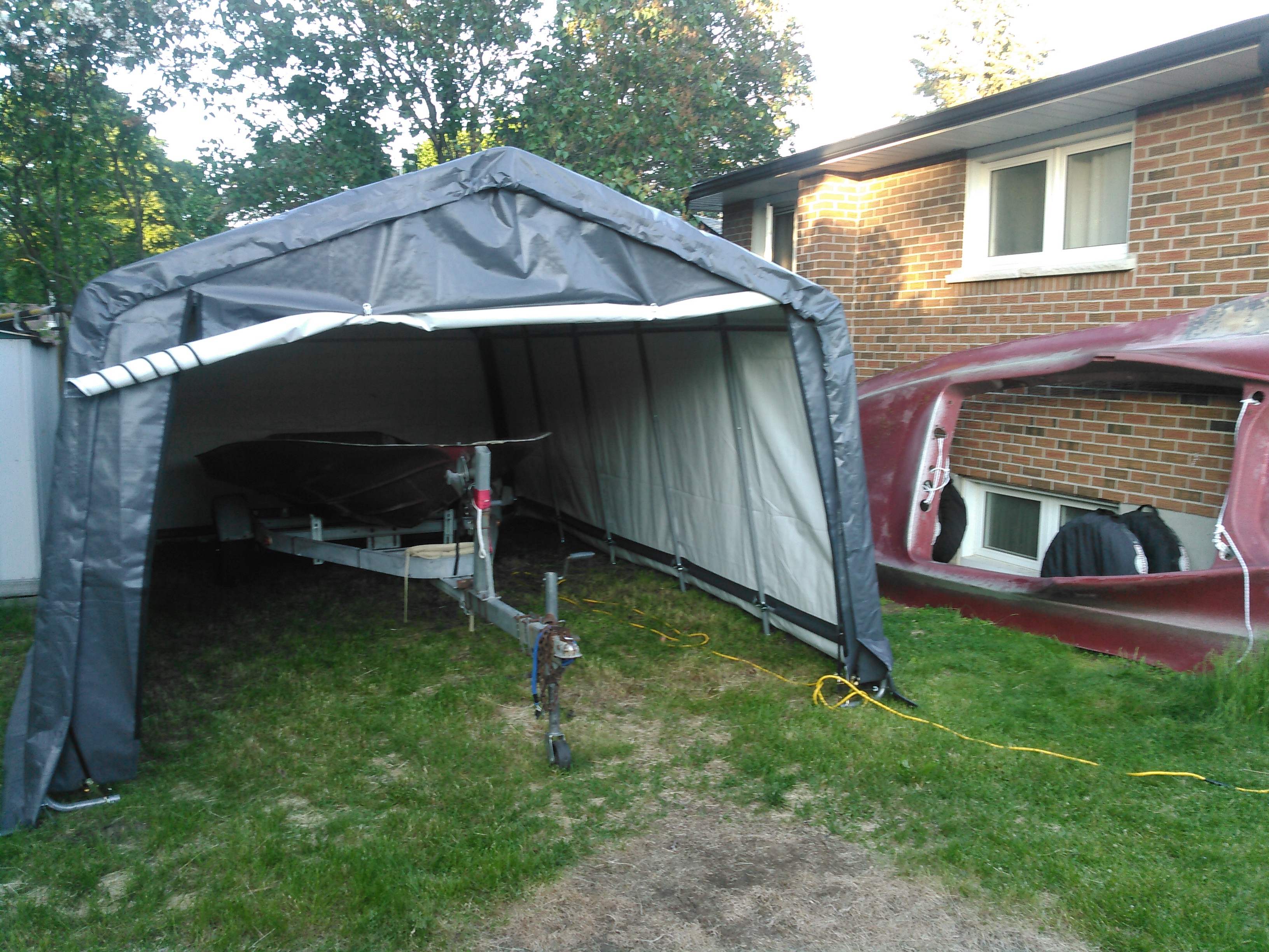

Well at least now I can work in any weather....
Time to build a new cradle like I had at my cousin's farm 3 years ago.

Built a "light" for my shelter. Powered by five 9-watt LED bulbs @ 800 lumens each. 4000 lumens total.
Finished the cradle. Didn't see a point in adding more supports under the bow as this isn't a weight-bearing area....i.e. i wont be stepping/standing there.

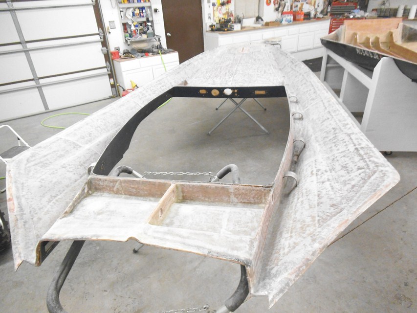

Deck Underside Deconstruction - Part 1
I haven't had a chance to buy more 1.5oz CSM, so I haven't been able to continue bagging the core in the hull.
I decided in the meantime to work on the underside of the deck.
The wood structure in it is in pretty bad shape, so tearing it all out and replacing it is the only logical option.
Started grinding with a 40-grit flap disc, but switched it back to my 36-grit brazed cup wheel.
Ah, you know what? Lemme deal with this weird thing in the middle instead.
At this point, I just started alternating between grinding, and whatever this green shite is. I still don't know what you'd call it.
It has the same texture, and crumbles very easily, like a 30-year old pool noodle.
Cut off the triangular lateral brace - inside was this soft foam, like you'd find in a cheap seat cushion...
Dash removal begins...
Removal of the flimsy 1/4" plywood...
My goal this weekend is to have the entire underside of the deck stripped of wood, and ground/prepped for 1708.

Adam, something to consider while you have your deck at this stage. I added these "looms" using a cut up cardboard roll. While rigging the hull, as was very glad that I added them. great place to keep all the cables and wires contained. Your project is looking awesome!!

Thanks Joe. Yours and Ron Pratts rebuilds are huge influencers in my build.
I actually bought a few packages of various sized rigid plastic "C" straps - the ones used for electrical conduits. Gonna 5200 those on when the underside is rebuilt.
