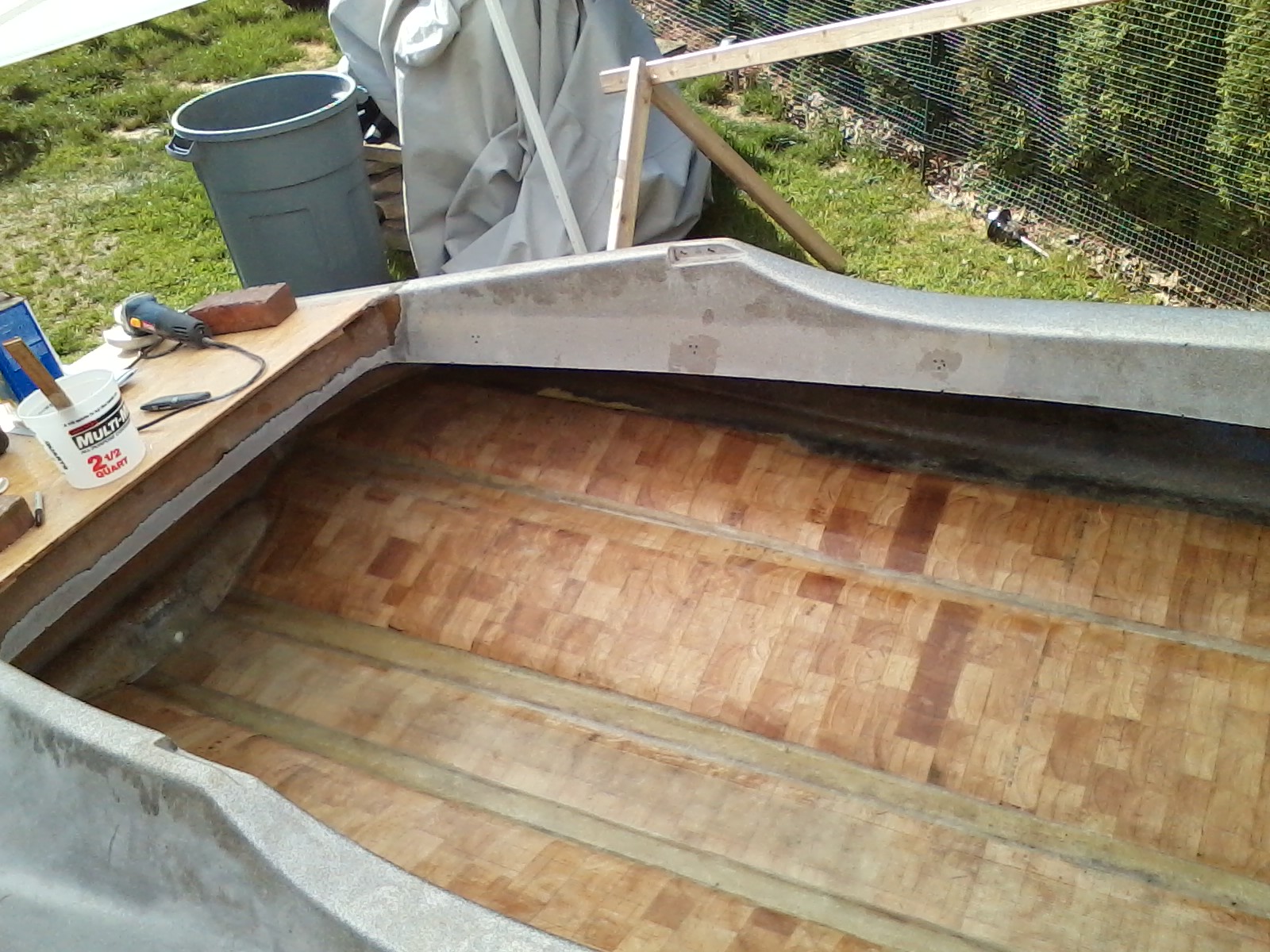

radiused core and glassed some in. next nice day the core glassing will be complete. then onto stringers
- port core glassed.jpg (328.96 KiB) Viewed 27452 times
- more core fitting.jpg (297.88 KiB) Viewed 27452 times

got the rest of the core sealed up. and ran out of resin. more money needed
and running low on glass. should have ordered 10 gallons of resin + hardener the first time. question for you guys, is a 6 inch tall stringer enough for the center and outer stringers for a non floored boat?
- core sealed up 2.jpg (465.63 KiB) Viewed 27453 times
- core sealed up.jpg (343.15 KiB) Viewed 27453 times

looks very nice. i never get tired of the look of fresh clean dry balsa, glassed over nicely like that.
say, i haven't read the whole thread, but what did you bed the balsa core into? did you mix up some kind of paste?
also, since the last post was just before summer, did you manage to get out on the lake with her?
-peter
-peter
- Posts: 181
- Location: MA
- Been thanked: 11 times
mixed resin and cabosil until it was a good viscosity to spread with a tile trowel. then i laid the balsa on top and pushed it down until it stuck well and flat. then glassed over the top later. the balsa really soaked up resin on the top, hopefully the bottom got enough to bond well.. I need more resin and motivation to lay in stringers.. finally got myself back to work the last few months, should be back into the project soon. still haven't driven itpcrussell50 wrote:looks very nice. i never get tired of the look of fresh clean dry balsa, glassed over nicely like that.
