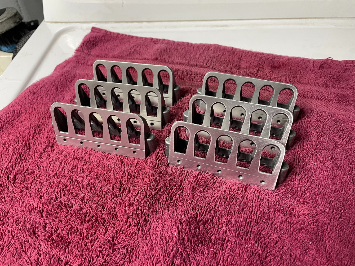

Went through the powerhead, installed new reeds, rebuilt the carbs, new fuel and bleed lines, new thermostats, rebuilt fuel pump and poppet valve, new stator and trigger and a new flywheel. My flywheel had a broken screw.
Fabricated a mount to run rigging hose on the clamshell cowl. Everything is hooked up at the engine, other than shift and throttle cables.
Trim and jack plate paddle switches are mounted on a custom stainless plate.
Trim and jack plate relays are wired in and everything works though the harness now. Only wiring left is the sending unit on the fuel tank and changing out the switch panel when the new one is back from the machine shop.
Coming down to the end. Spring fever is getting real!

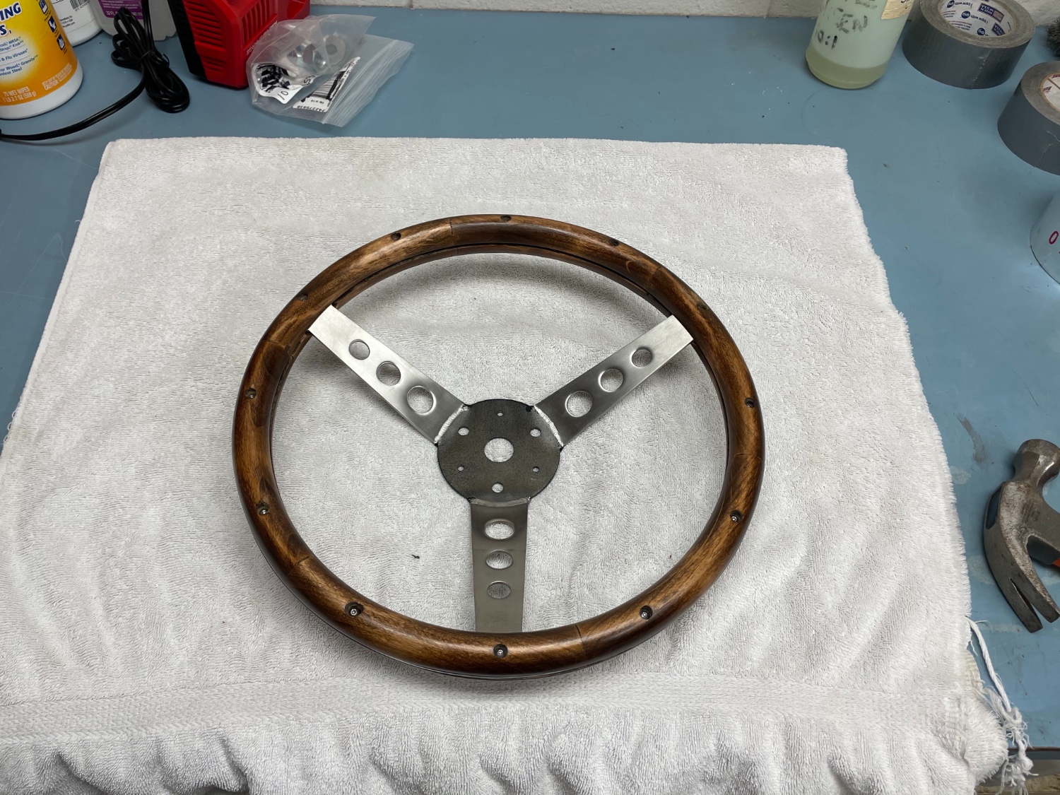

The steering wheel is finished and installed. I bought a Grant wheel and modified it to work better with the paddle switches and to fit the original hub. I wanted a new wheel to have a 13" with the hydraulic steering vs the 15" original. The original hub was also modified to work with the SeaStar helm. A new center cap for the wheel was made to look like the original. The original was either lost or broken.
The windshield is on for good. The lower trim got lost in the shuffle from when it was removed 15 years ago. So a new one was fabbed from a leftover piece of the rub rail that was formed.
Control cables are connected to the engine, so now everything is connected to the engine that needs to be. Once I get the lower unit resealed I can test fire it.
Just a few little things left to button up and she can get wet.
