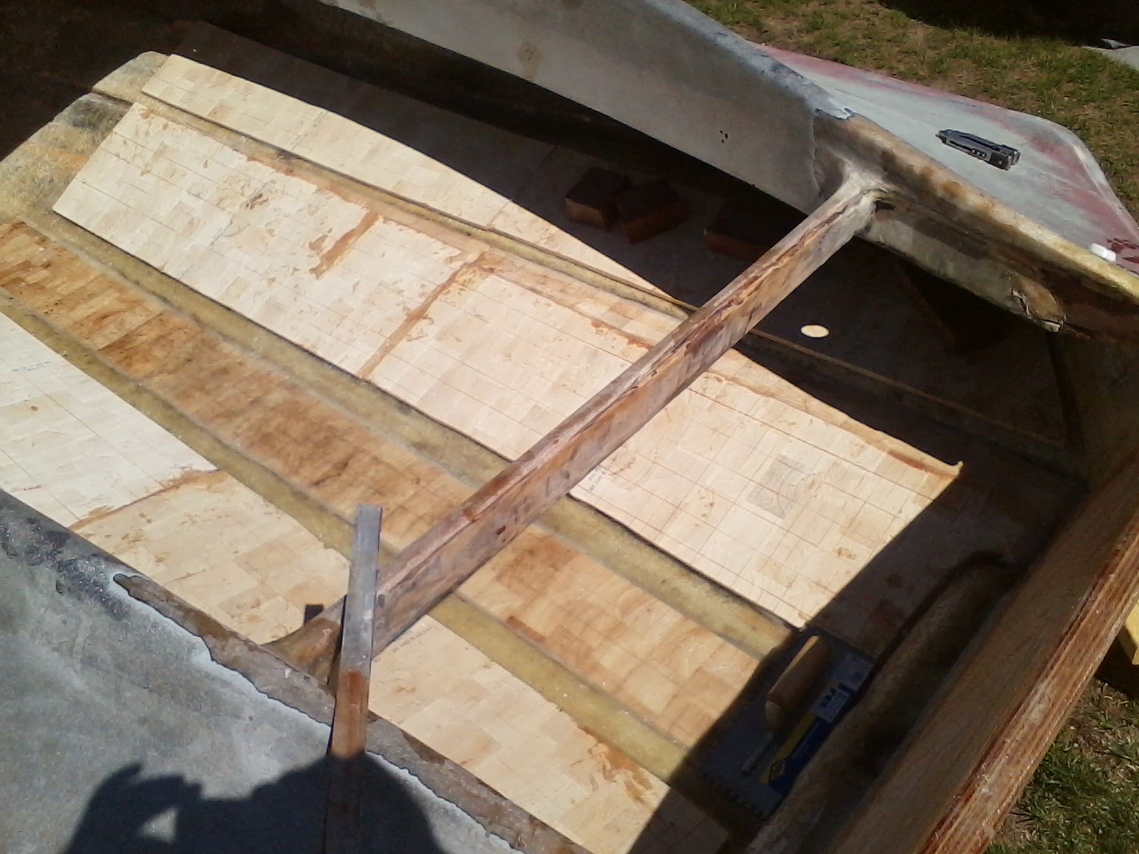

Post: # 20153Post aaron78viper »
okay, so the time finally came, ordered up some balsa core and cabosil to bed it down, got the glass I will need, and I patched up these damaged spot on the bottom. Now, for the smaller chips in the strakes, and some sharpening on the edges, what should I use? Need guidance for the chip repairs along a lot of the strakes, and sharpening the edges near the rear

Post: # 20163Post aaron78viper »
had some beautiful weather today, so I started my core install in the pad. have the boat hanging naturally from the bow eye and weight supported on the rear corner of the strakes that are at the bottom edges of the transom. nothing will be pushing on the flat parts of the hull, and it seems extremely straight that way. here is how it looks right now
splashwell delete being installed not glassed yet.jpg (351.36 KiB) Viewed 30653 times
core being bedded in update.jpg (370.16 KiB) Viewed 30653 times
core being bedded in update left.jpg (367.12 KiB) Viewed 30653 times
