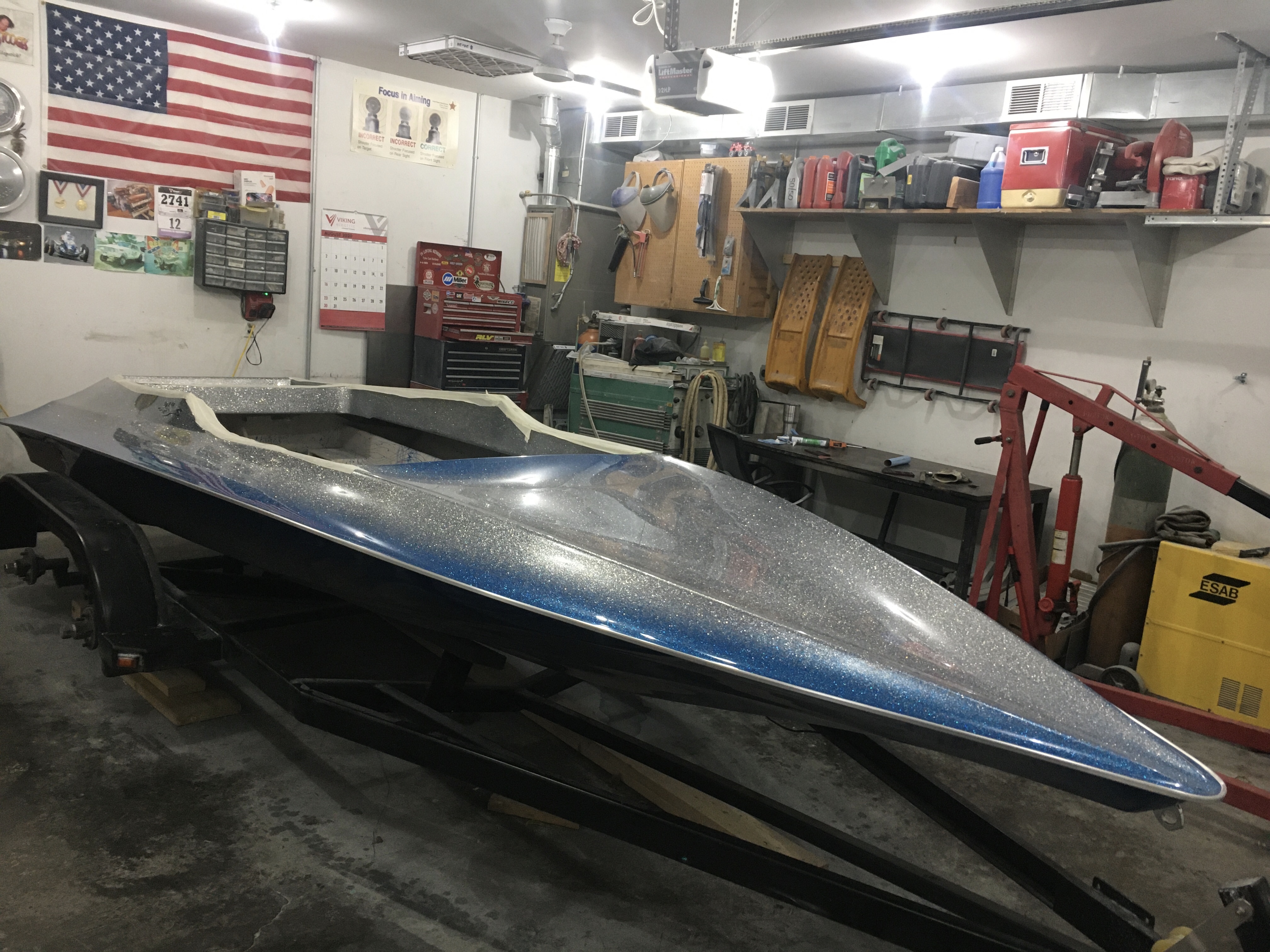

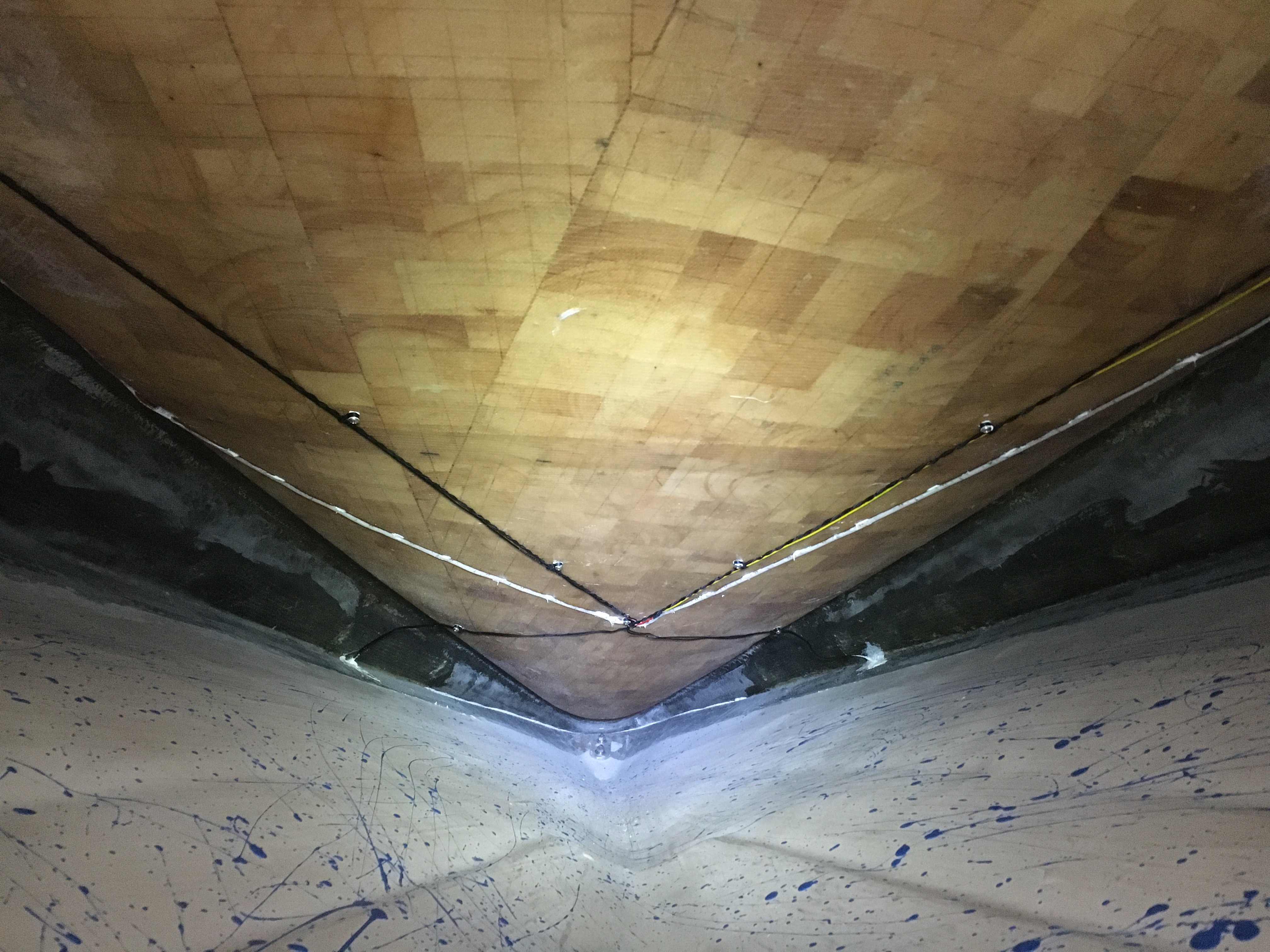

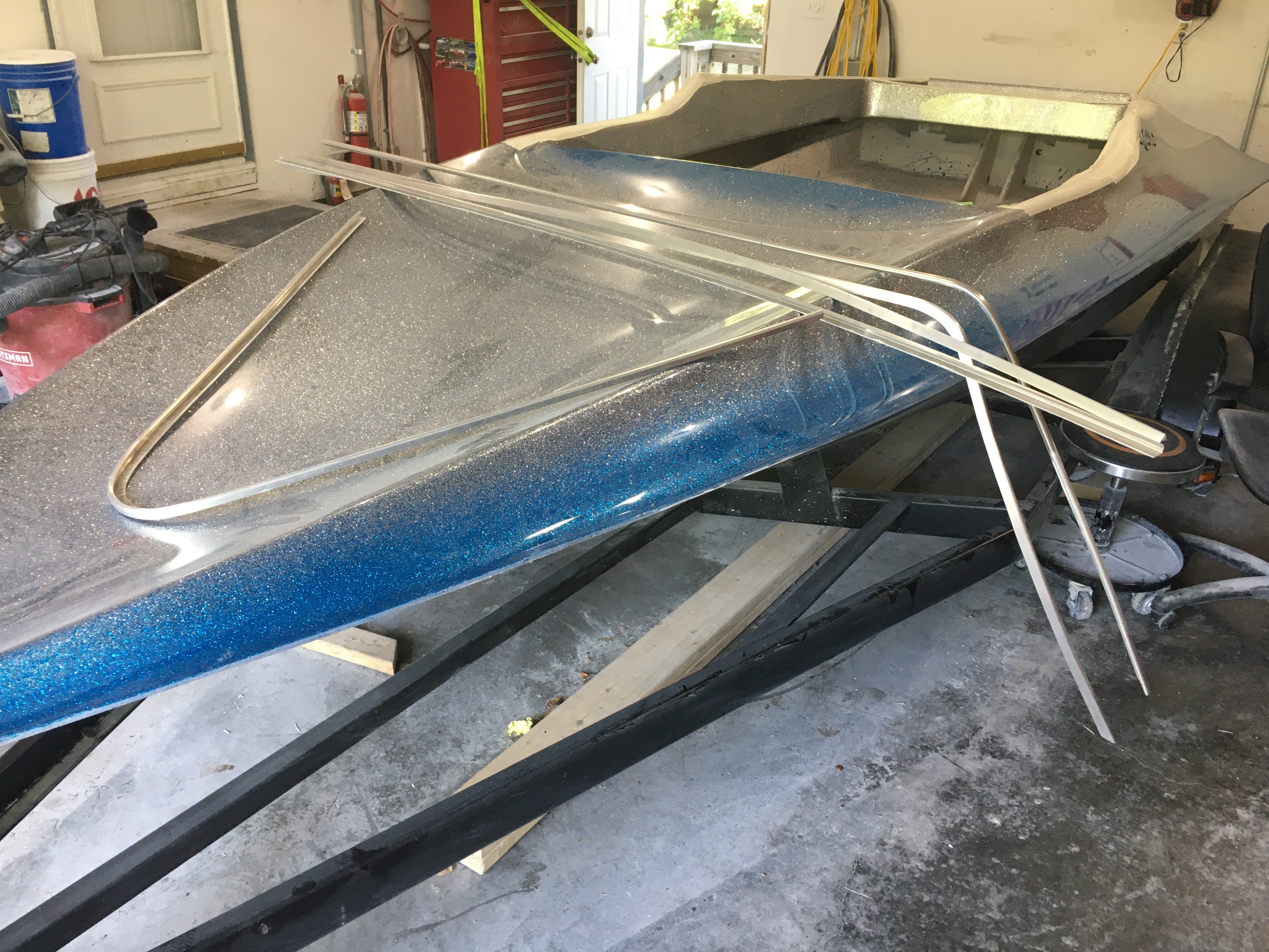

In this months update,
All the holes in the transom have been drilled. They were drilled oversized and then thinned resin was brushed into the holes, allowed to soak into the wood, and before it cured a resin putty was packed into them, creating a solid resin plug. The final holes were then drilled through the resin.
Brass drain tubes were pressed into the splash well and bilge.
Transom tie downs were bolted in.
New rub rail was fabricated from aluminum sheet metal and installed.
Deck supports bolted into the stringers.

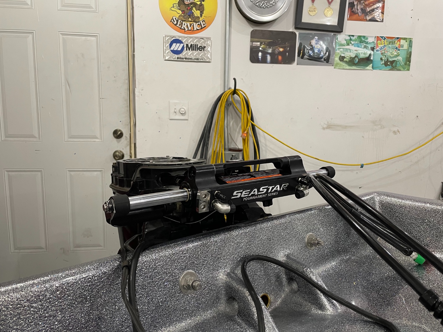

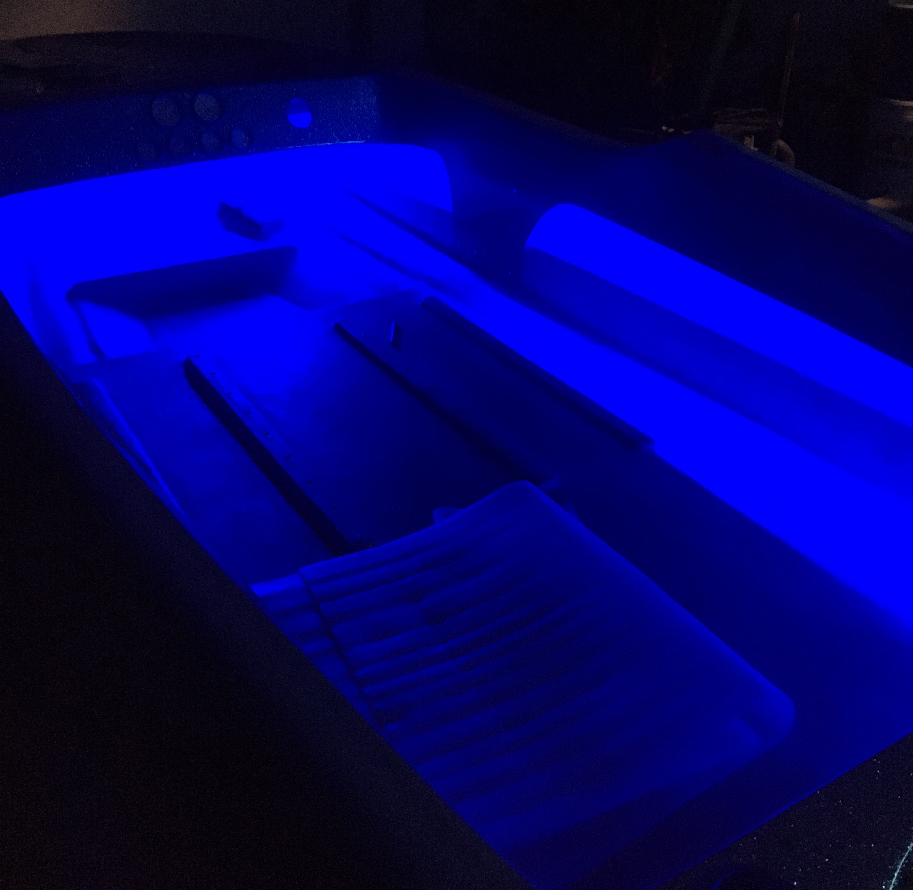

In this months update;
Jack plate and clamp are installed. I need to pull the tiller and sand blast/paint it.
Gauges are installed and wired.
Sea Star Pro 2.0 helm, hoses and bulk head fitting installed.
Custom fuel tank is finished.
Navigation lights, interior lights installed.

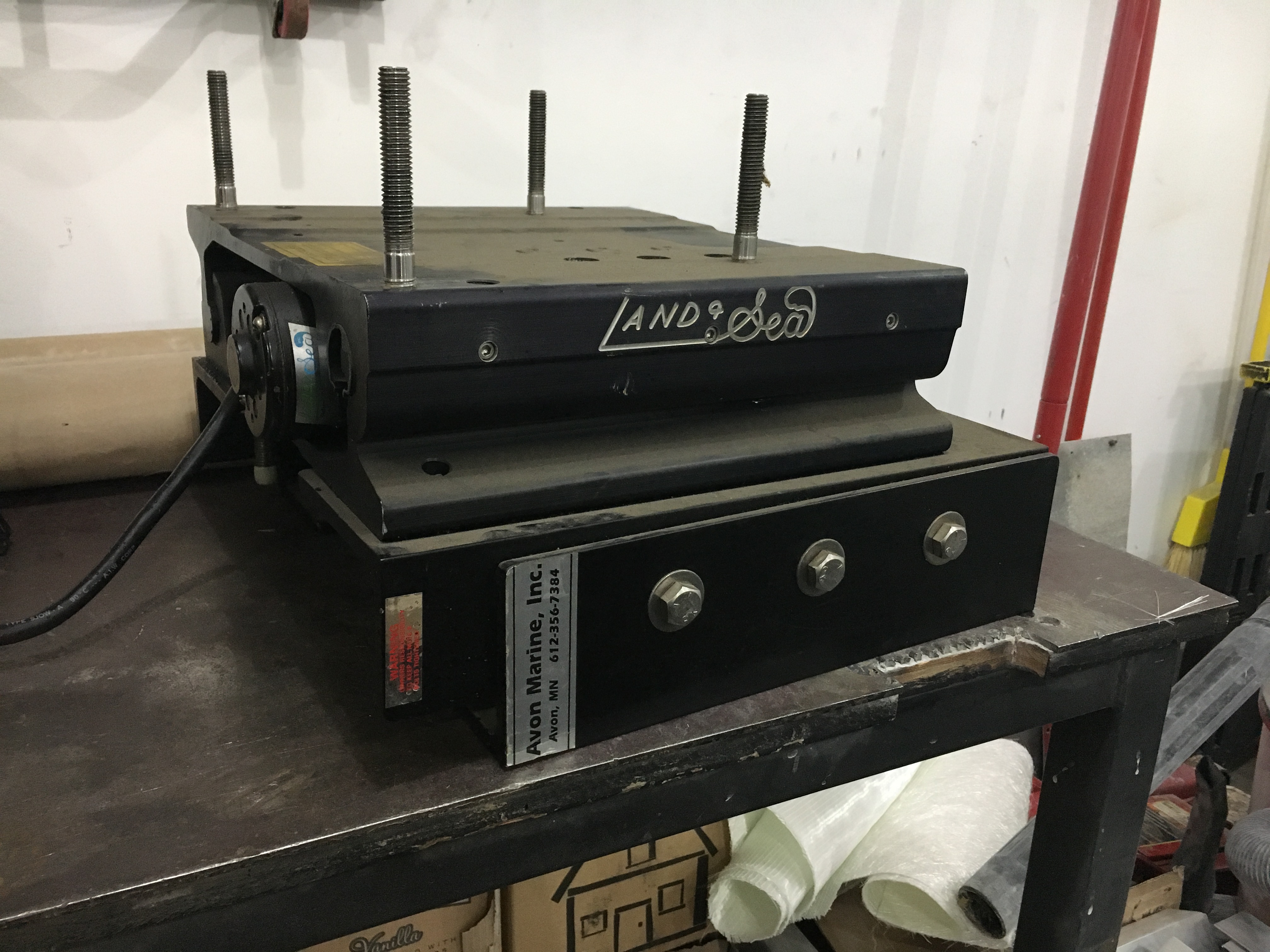

Looks sharp! That jackplate looks like an old land n sea, have you checked the nylon bushings on the slides? They're nla, so hopefully yours are in good shape.
Re: 1978 Viking resto-mod
Thanks!
It is an old L&S. Its basically NOS, so the slides are brand new. He said it was only used a few times. I'm actually considering pulling one out and seeing if I can get a bunch remade since so many people seem to need them.

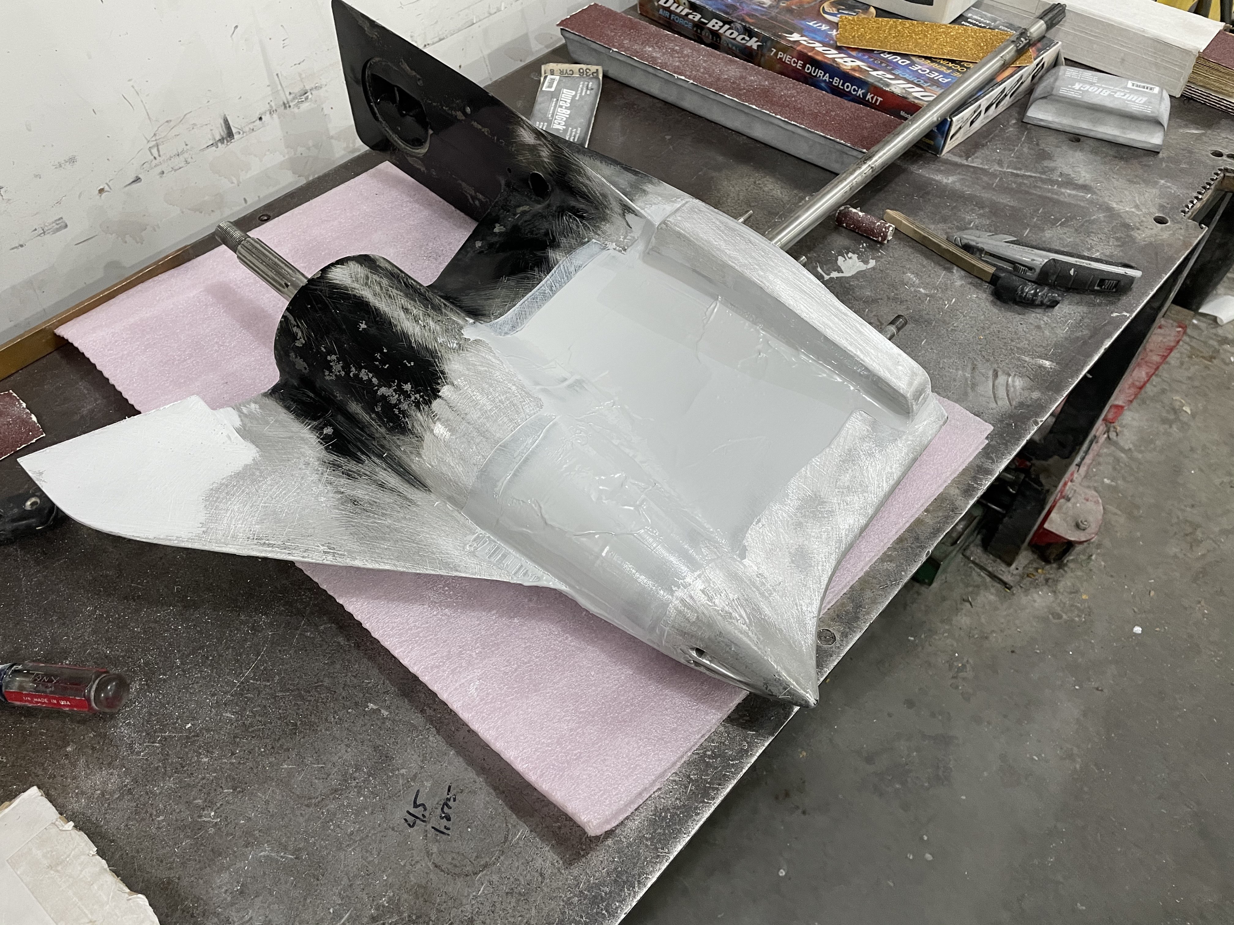

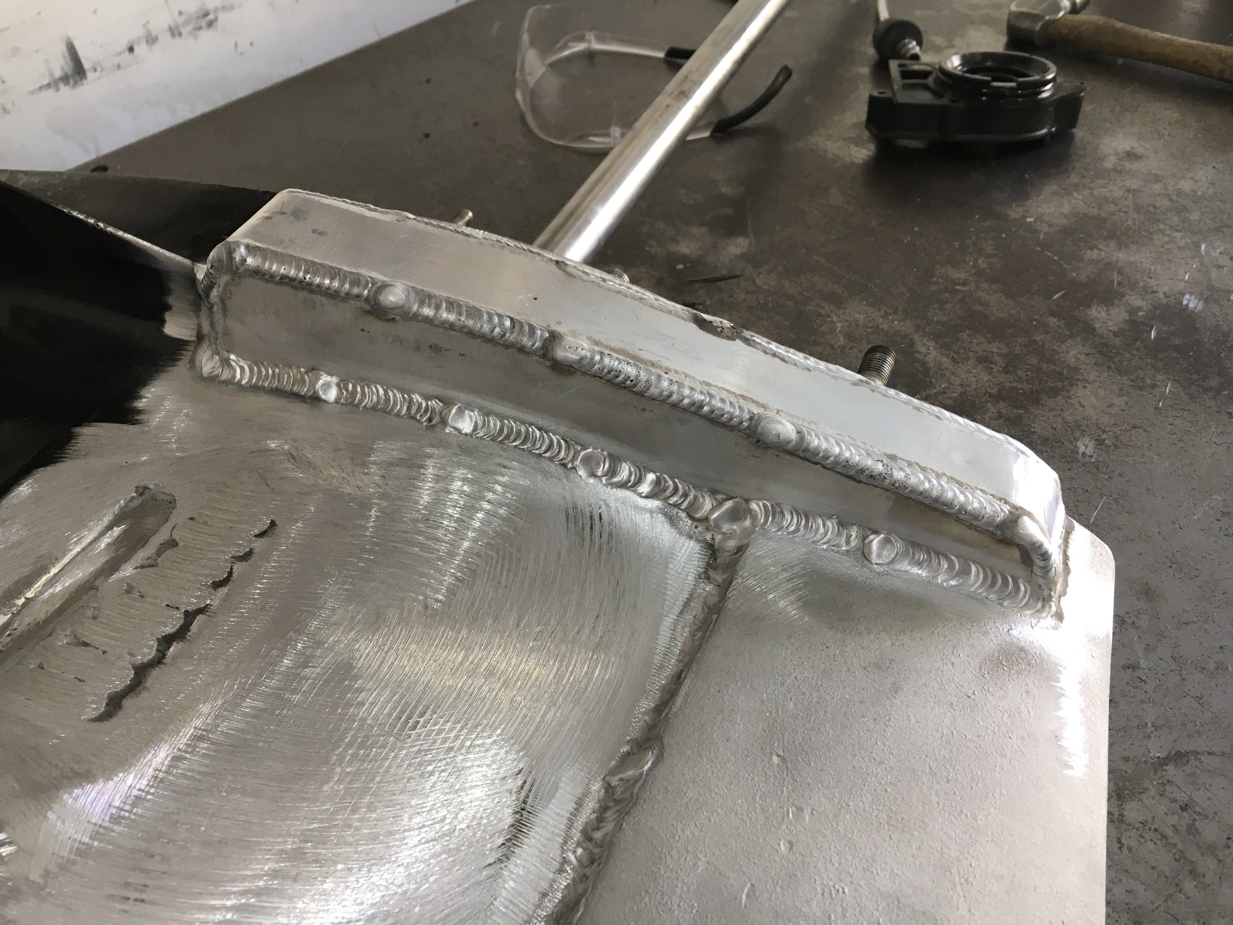

In the last month I've been a little busy with other things besides the boat. But I did get a big jump on the nose cone. I modified the bobs cone by filling the furtherest starboard intake hole. I also chamfered the remaining holes a bit. I built a water passage from sheet metal instead of using a hose, I've just never liked the look of a hose. The cone and passage are both 100% TIG welded. A sheet metal torque tab was added to the skeg. I used the epoxy putty from bobs to start fairing out the lower.
I've been slowly plugging away at the wiring harness as well.
Bigle pump instal is complete. The drain tube routing is a bit complicated due to the complete lack of space under the splash well from the large fuel tank I built.

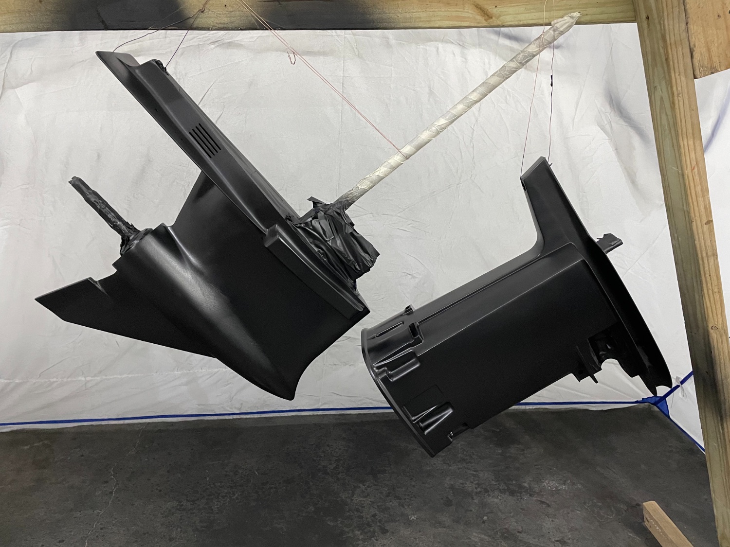

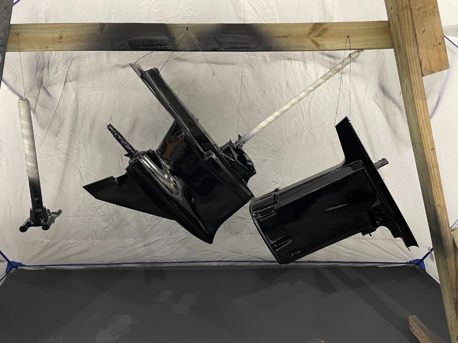

The interior work is finished and just waiting for upholstery at this point. That is the one part of this build I'm going to farm out and pay a pro to do. I have none of the required tools, or space, and it's a very visible part of the boat. 1/2" Bluewater 26 Coosa was used to rebuild the factory style back to back seats. I'm pretty heavy with the hull so now trying to save a bit of weight where I can haha. 3/8" PVC board was used for the gunnel panels and the rear panel.
The work on the lower was finished and was painted along with the mid with an epoxy primer and single stage acrylic enamel. I found a cheap "paint booth" on amazon for about $45. Like a 3 sided camping tent. Worked well to contain most the over spray.
The mid, adapter plate, solid mounts, SeaStar tournament ram, and power head were installed.
She's getting close!
