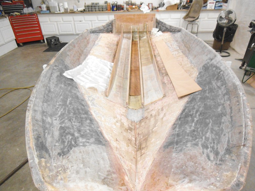

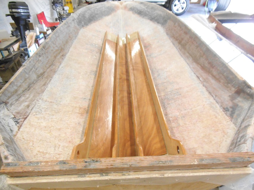

Finished up installing all the stringers, inner core and flooring and ground out all of the outer core area with a longboard and some 24 grit paper. Got a nice flat surface and the 24 grit gouges should give the core a good mechanical bond.

proprider, what is that wood between the stringers?? im guessing thats for more rigidity on the pad? what kind of wood is that?

The wood between the stringers is 6mill.-5ply Ocume plywood. I had it left over from another project and used it as a laminate over the core. The boat is going to be rigged as a lake racer and the flooring won't be getting that much "traffic". It is some pretty stout wood and my plan is to leave it a natural finish, it has a beautiful grain and would be a shame to cover it up.

so this is gonna be a stringer hull? i agree it is very good looking. a cool idea for someone who is making a stringer setup!

Yes, the hull will have open stringers with center steer and tandom seating. I plan to use the outer set of stringers to mount my shifter, kill switch, fire extinguisher, ect...aaron78viper wrote:so this is gonna be a stringer hull? i agree it is very good looking. a cool idea for someone who is making a stringer setup!

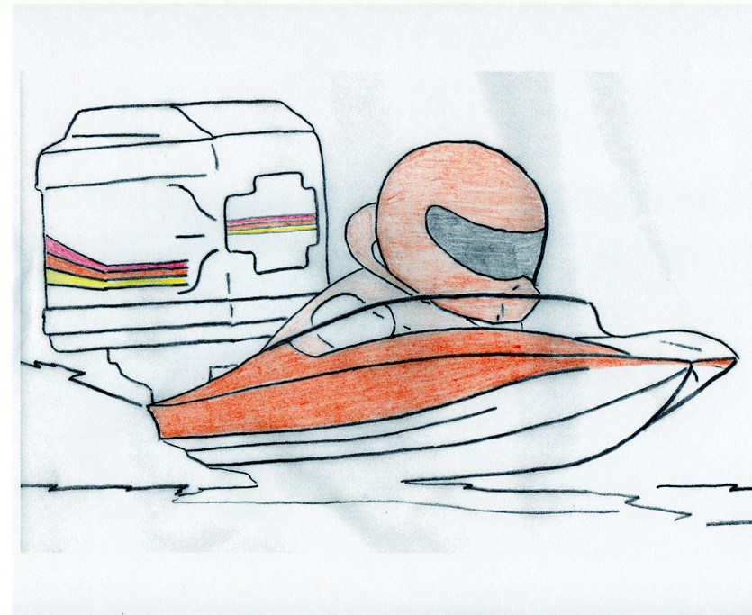

While cycling through the constants of sanding, glassing and itching, I find myself daydreaming of my finished Viper. I got some more core bedded tonight and got done early. Came in the house and sketched my thoughts on paper. This is what I cameup with........
