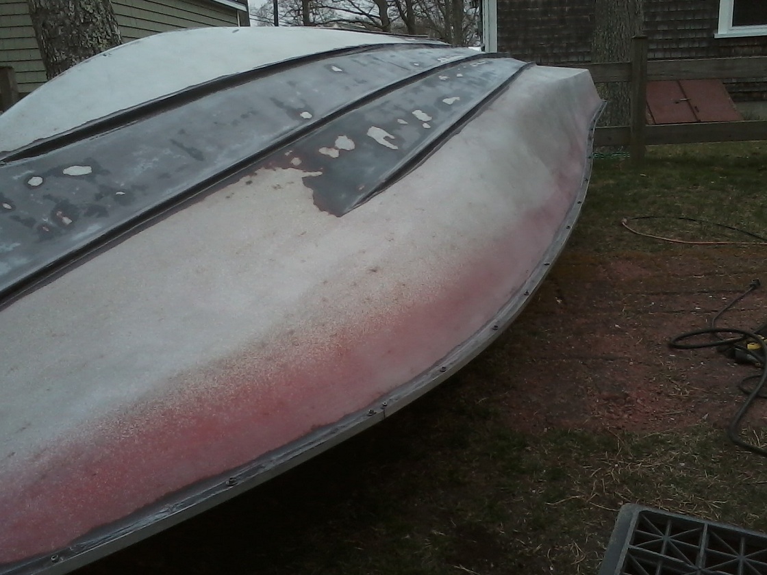

Started to sand all the paint off. there is a crazy amount of paint on this thing. I feel like im finally seeing the personality as i reveal the colors underneath
- 4-19-13 sanding progress.jpg (239.36 KiB) Viewed 24033 times
- 4-19-13 sanding progress3.jpg (298.81 KiB) Viewed 24033 times
- 4-19-13 sanding progress 2.jpg (305.12 KiB) Viewed 24033 times

I think i got about 30 pounds of paint off by now. So much dust every time i get on it... How do you guys bed in airex foam core? is the bedding compound/"glue" the same as balsa? where do you get it?? And what do you prefer? stringer on top of core? or stringer down first then core between? I was thinking stringer on top...
- 4,25,13.jpg (360.18 KiB) Viewed 24010 times
