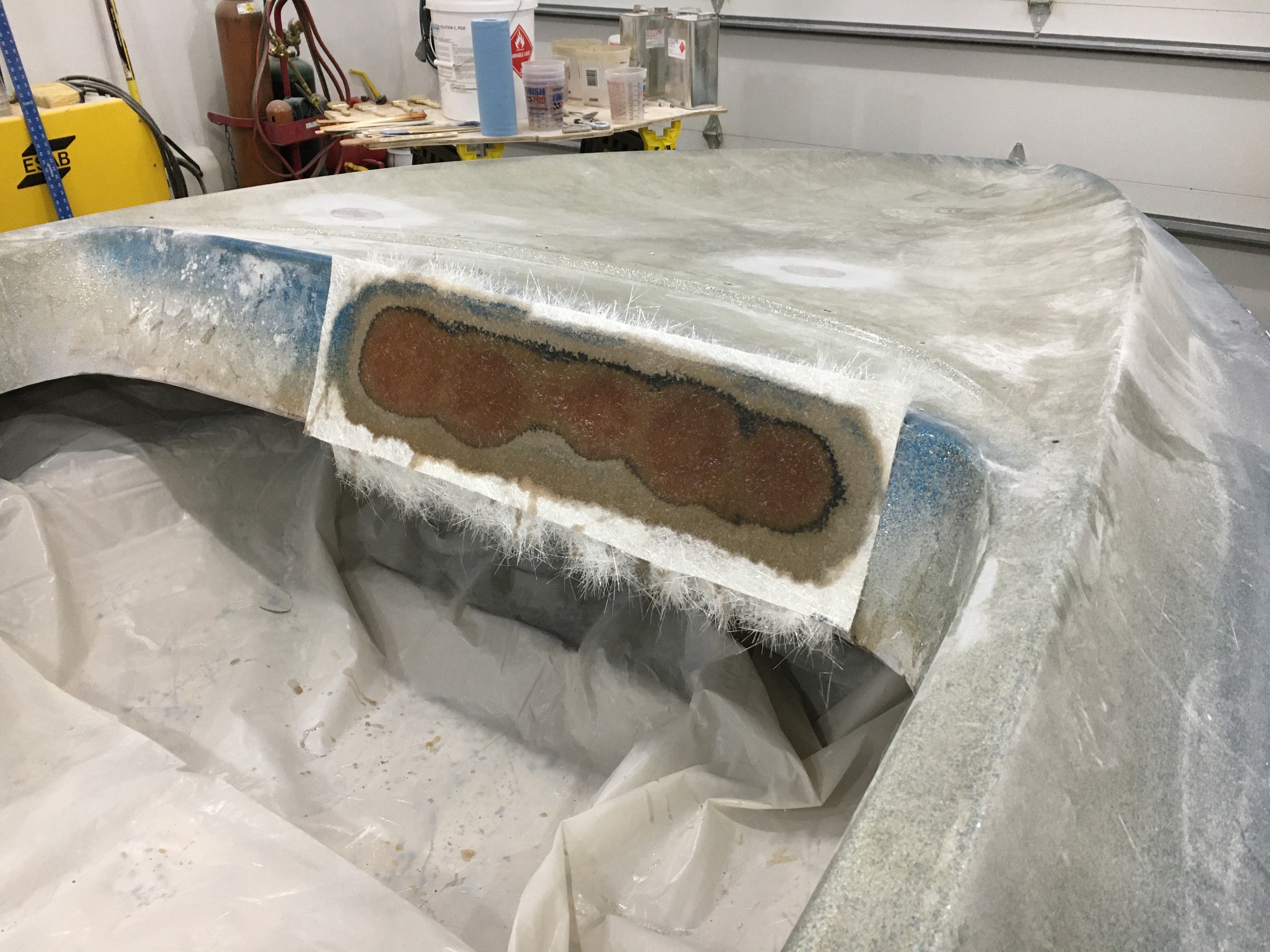

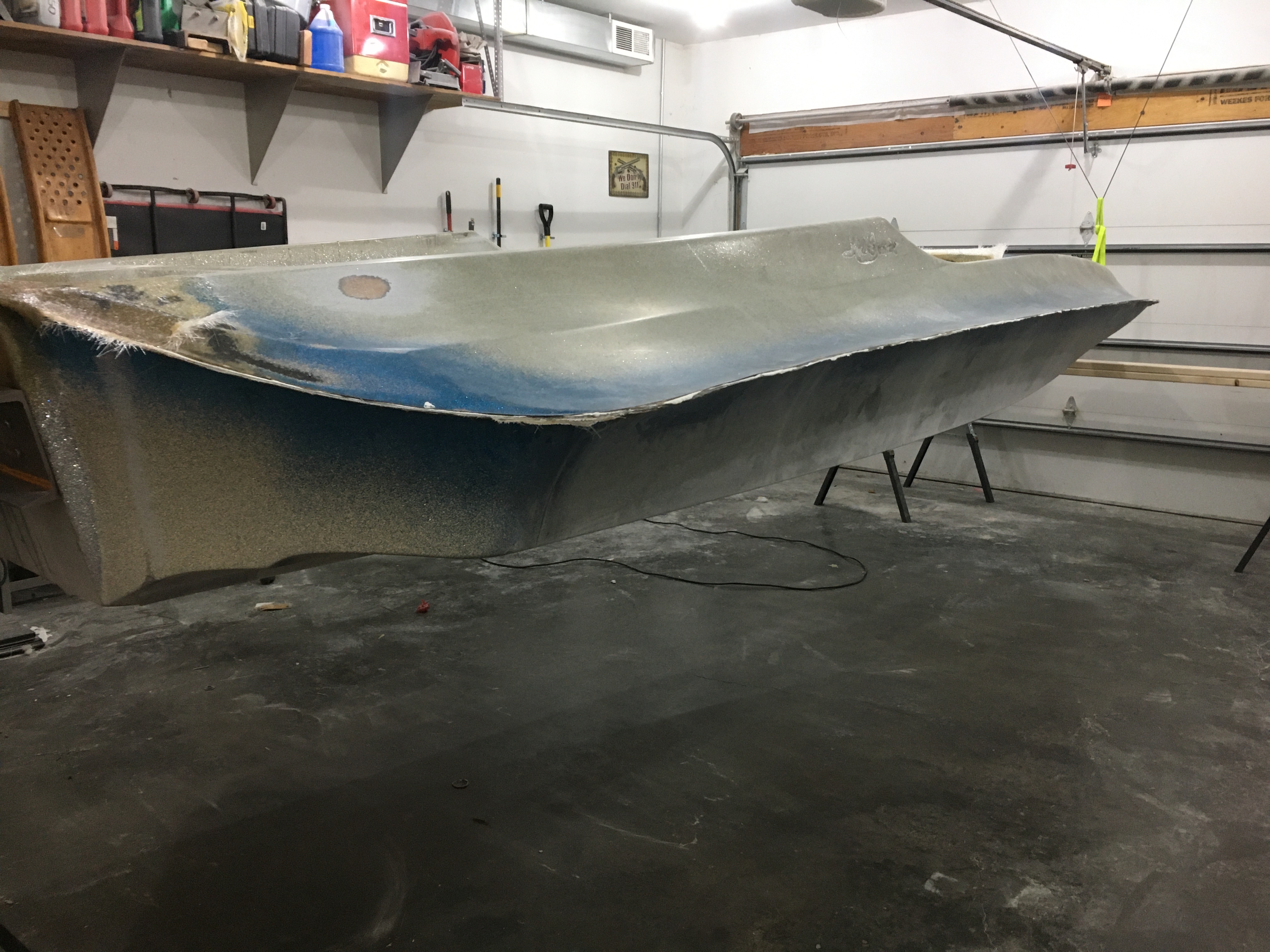

The boat is out of the cradle and flipped over for the bottom work. Repair all the damage, blueprint the last 6', and spray new gel with the same metal flake.
I finished glassing in the splash well before flipping the hull. Made a simple mold to form the drain in the well. Used parchment paper to cover it for a release.
The hull/deck seam was glassed on the inside with 2" CSM and 4" 1708.

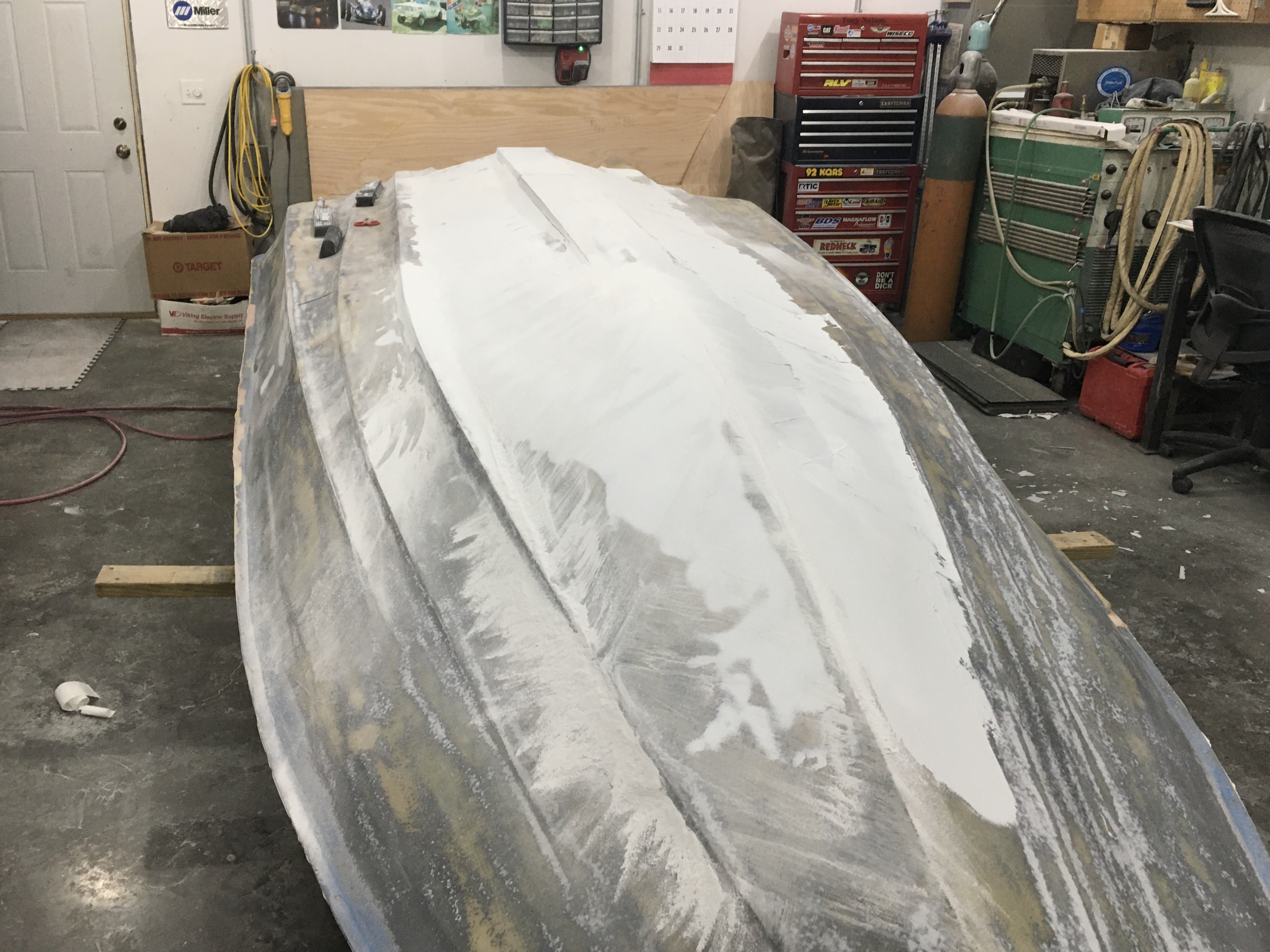

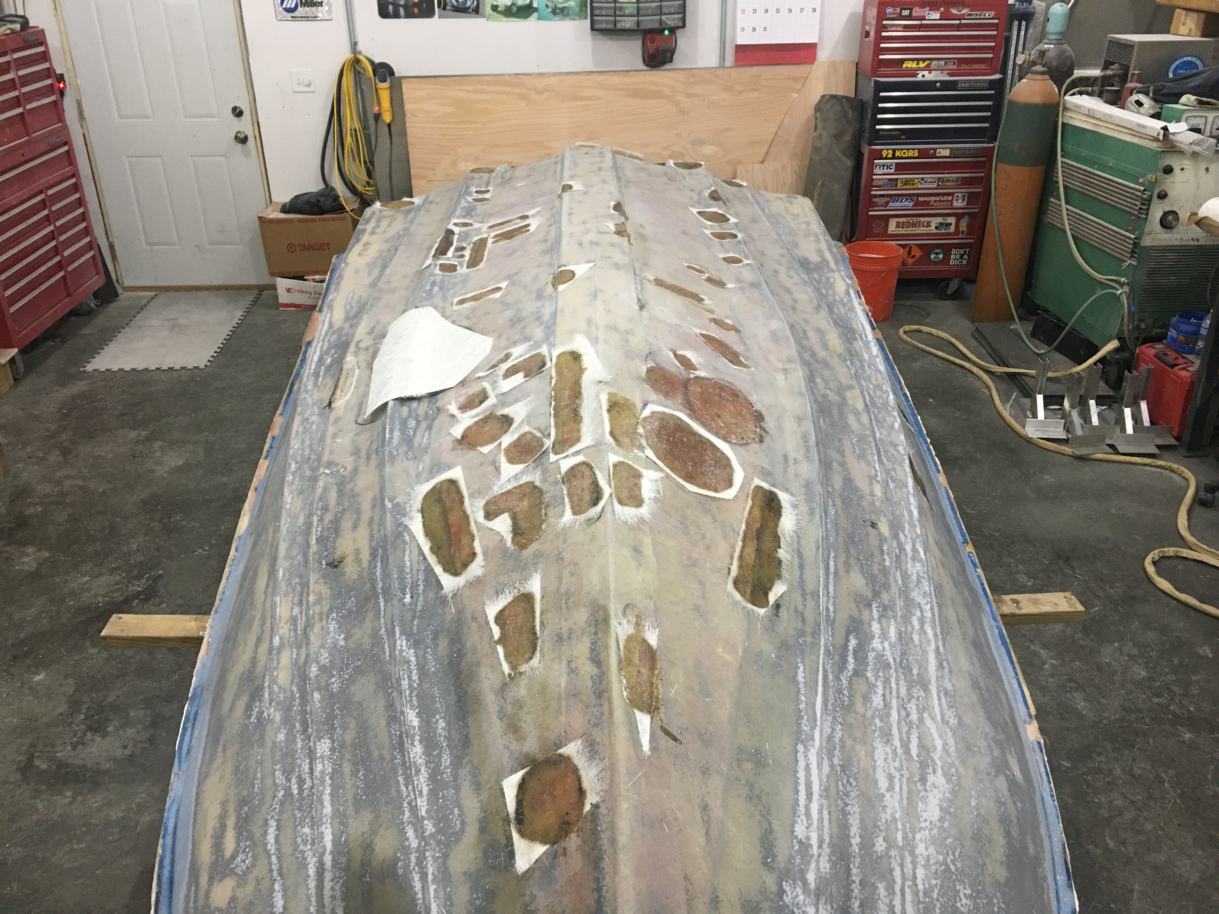

Started in on the bottom work. Found an awful lot of stress cracks, any of those that I could catch with a finger nail I ground out and patched in with CSM. Most spots only needed one or two layers of mat. I'm now working on the blueprinting process. I have the first layer of body filler in and sanded and starting in on the remaining low spots.

Blueprinting has been completed! Also got the primer on.

Bottom is gel coated!
