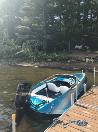

I am running a 1983 mercury inline 115HP with a 22 laser II stainless. 120 PSI all 6 cyl. Bolted to transom no jackplate and no low water pick up. fastest i got it was 58 MPH on GPS. once i got past 50 i was pretty much airborne revving at 6000. to high for this motor...
Everything was pretty much redone, stater, rectifier, plugs, wires, lower gear seals, water pump, power packs ,solenoids, carbs rebuilt, fuel pump, fuel lies, etc. I am now going to have to take the power head off because i have water intrusion in cyl #3 (common for theses motors) . i will be replacing all the seals from the exhaust plates this spring. its never been rebuilt and the motor was sitting close to 10 years.
to much trim can get you in trouble for sure that's why i will invest with a jackplate and low water pickup. in the future i would like to find a Mercury XR2.
Here is a picture of the motor when i first bolted it on. nothing was attached yet (steering cable, hydraulic hoses. etc. ).
Mercury Laser II 22P. i a 24 as well, the 24 is better cruising but there more snapp with the throttle with the 22. did not gain any mph with the 24. I just picked up a quicksilver 2 blade 23P bronze speed prop i am curious about. if I can break 60 mph that will be a mile stone ive wanted to achieve with this setup.
