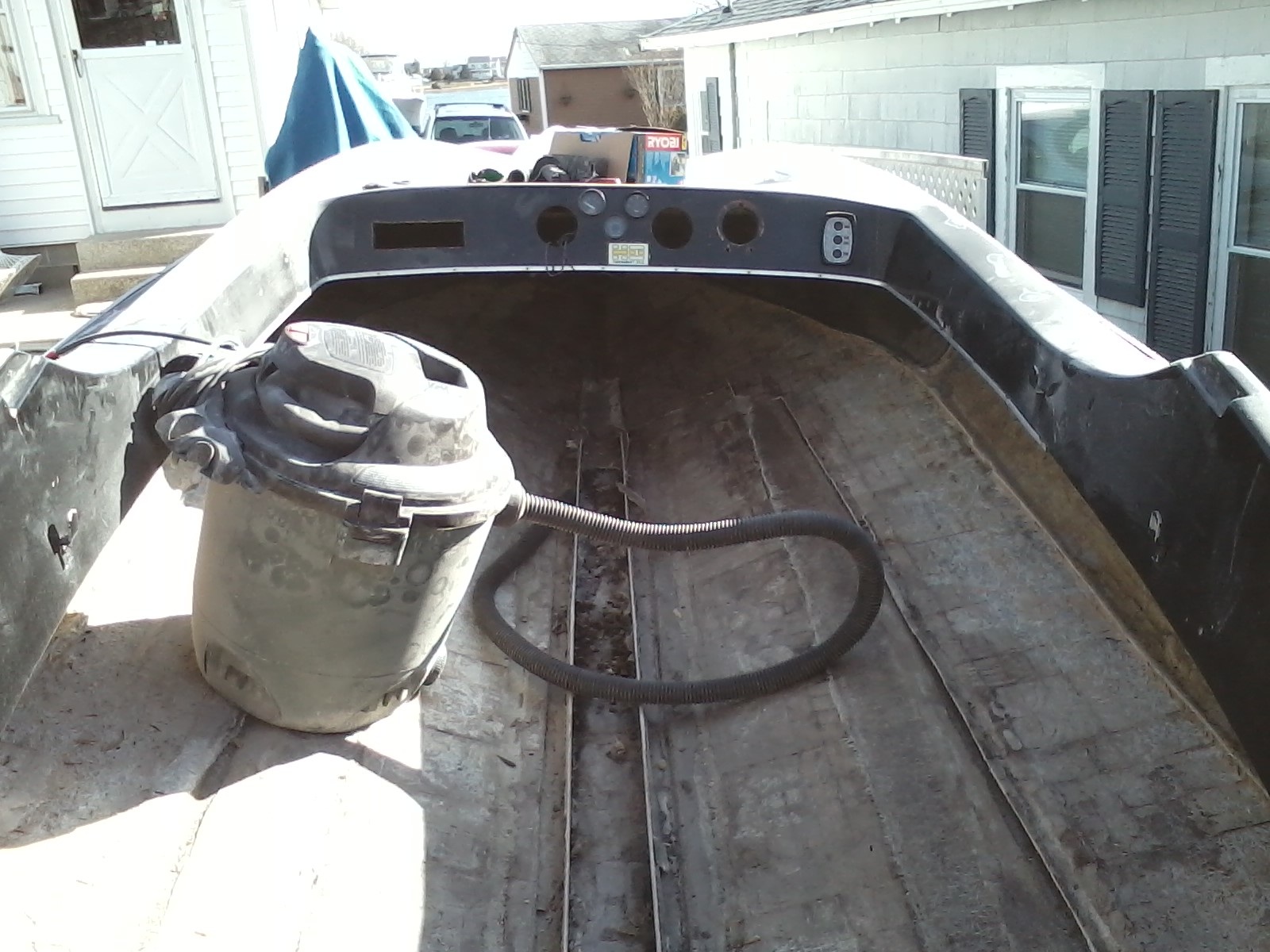

so ive began to work on the viper again when the sun is out. the transom is out, i have a sheet of 1/2 inch marine plywood ready for that. and im about 95 percent done with removing the core.. i tend to jump around from one part of the project to the other
but im doing my best to keep moving on it. now that its getting closer to rebuild time, im wondering where i can find a vacuum pump that is appropriate for the project. any ideas? i will upload pics as soon as everything is ground down to the shell. not quite there yet

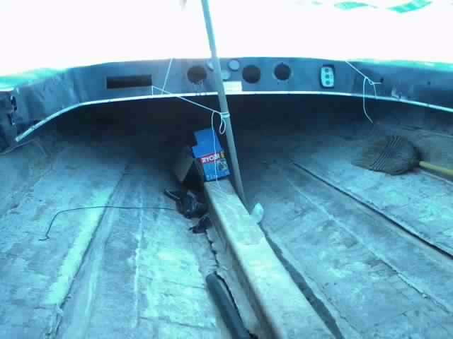

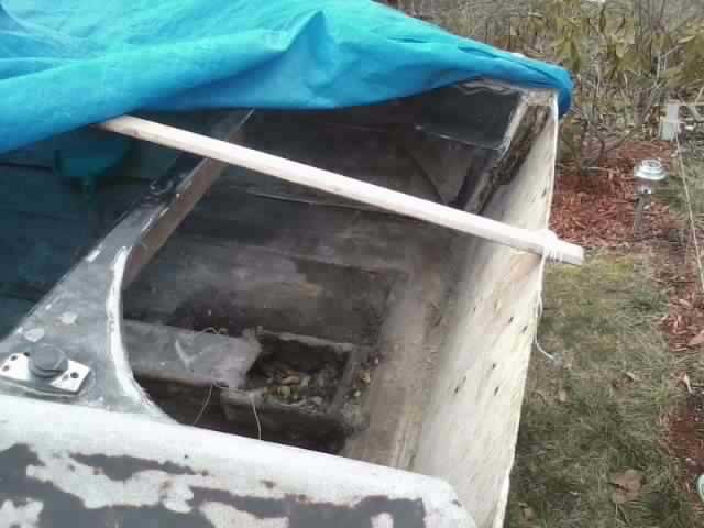

did more digging now that the weather is starting to turn here.. got the splashwell out, transom 99 percent out (some wood is still planted on the outer skin). I still need to either build a jig or modify the trailer to a bunk.. so I havent cut that center stringer/airbox out yet.. it seems like it would be okay, but im nervous.

Your stringers there, there is core under them so your gonna want to take em out and take that core out. When your done and have everything out and cleaned up it should look similar to this...
This of course is a Vulture but pretty much the same.

thanks hippie. i do realize that the stringer needs to come out.. i need to either support the trailer or build a jog like proprider. i am leaning towards the jig and working on the trailer in the meantime, its still a roller
i know i know it needs to be changed

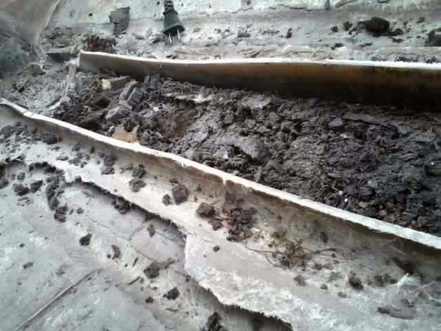

I finally got to do a solid days work today, cut out the air box, which was hiding the worst of the rotten core. Apparently, hydrostream did a poor job on my pad area from front to back, super dry glass work, nearly seethrough mesh. Even under the balsa was unsaturated sheets of glass pulling out. I am shocked it never delaminated.
