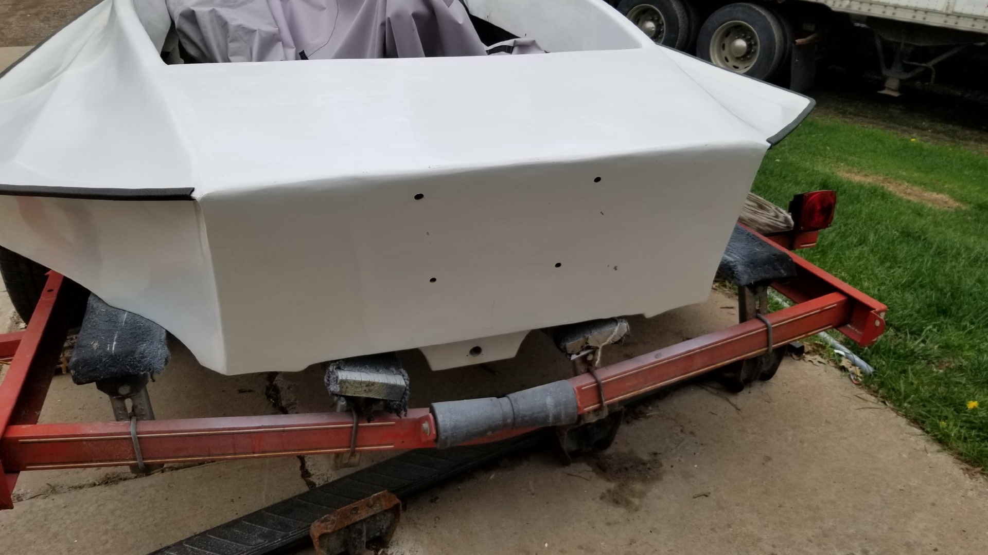

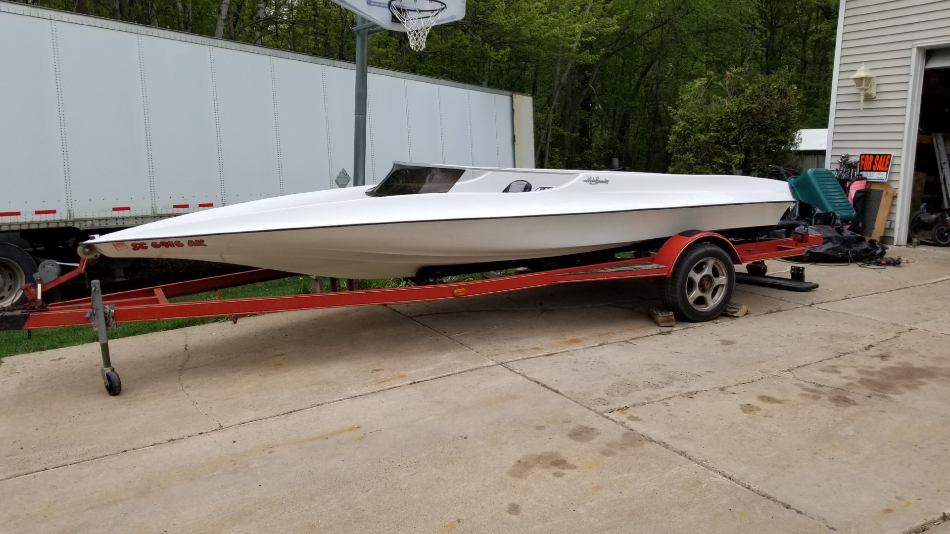

Post: # 24898Post Hippie459MN »
Some more updates...
On Saturday morning kiddo and I hooked up the boat and ran down and met up with RJ to get finally get the transom drilled using his fancy jig so it got done properly.
After that, it rained for about 36 hours straight so no more work was done, but at least that was FINALLY done!
And today (Monday) after work I got the ambition to finally get the rub rail put on now that I finally got the rear of the boat painted, enough, to get it on.
Got it all on and what a huge difference it makes. The picture doesn't do it justice at all.
And I decided to set the windshield on there and see how it looks now and WOW... It looks SOOO different and it looks amazing! I cant wait to see it with the motor on it.
Stay tuned... :mrgreen:

Looking good Kevin!!!
One trick I do is to hit the holes in the transom with a countersink bit to create a bevel in the gelcoat. This little void holds a little extra sealant. Seemed like a cool idea when I thought of it and do it all the time now.
Ohhh and please,...for the love of God,......don't use 5200!!
Your not trying to glue the motor on the boat. Thats what the bolts are for. Good ole' 100% silicone is perfect and you can get it off when you pull that motor. Which you will.......... because it's an Evinrude. LOL.... Kidding....
Re: Project Hydrostream Vulture
Post: # 24901Post Hippie459MN »
Great idea on using a countersink bit on the holes. I will absolutely do that.
As for the 5200, I will not be using that. Haha Going to use 4200 that way if I ever need to take the jack plate off, I can. LoL
