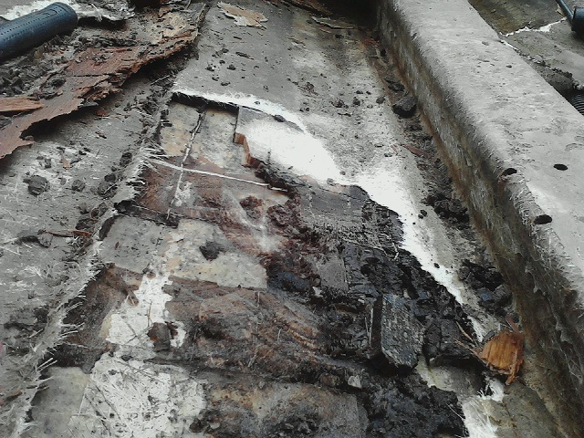

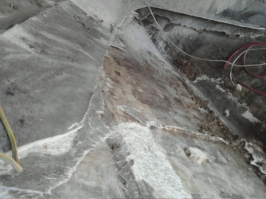

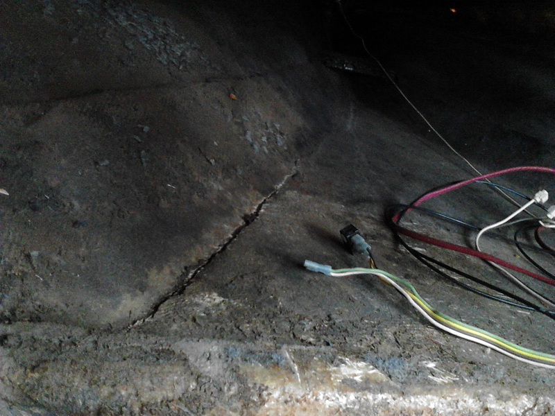

did a little more digging.. i know i make small improvements but i need to pick up a grinder and cutting wheel.. today i was vaccuuming and found that the floor and the hull were seperating in the left bow. and i was feeling a soft core standing in the boat so i pulled up a two foot or so section and found a mushy balsa core. glad i joined the forum or i never would have known about this stuff.
hydro. first look into the core. rotten 1.jpg (179.13 KiB) Viewed 9627 times
hydro. long crack from hull to floor in bow. left side 1.jpg (175.07 KiB) Viewed 9627 times
HST4ME

mushy is good, makes for a easy demolition. it really sucks when 1/2 the core is still decent, but it all as to come out anyway .

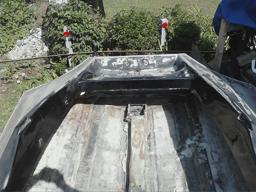

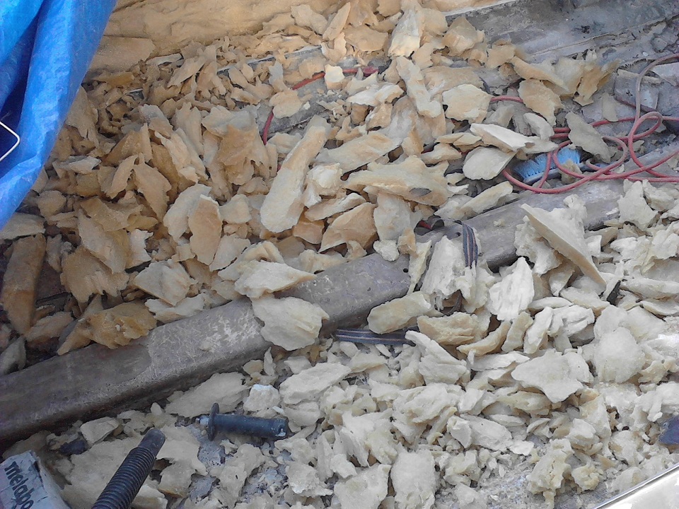

did a bit more work. cut out the floor up in the nose and a bunch of the float boxes. windshield is off. did some sanding. i was shocked when i saw how much foam they managed to pack in this little boat.
foam from float boxes 1.jpg (304.09 KiB) Viewed 9562 times
Post: # 15772Post YDOC462 »
all too familar

Post: # 15796Post 265mercman »
yes indeed lol thats why i love my comp hull no foam or wood just fiberglass except the wood in the transom looking good keep on keeping on befor you no it youll be showing pics of new core being laid and then motor mounted then in the water

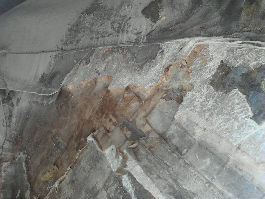

has anyone found a quick way to get the good balsa core off the hull? the rotton stuff either falls out easy or take very little force but there is a fair amount of good balsa that i cant even dig into with a screwdriver. how do you guys get that junk out?
Post: # 15981Post VultureNo2 »
We chiselled mine out with a screwdriver and a hammer like little wine bottle corks. I'm sure there are better ways though. I was just to new and afraid of poking holes in the bottom. It took us 6 months that way. Hopefully someone with come up with a better answer. Bill

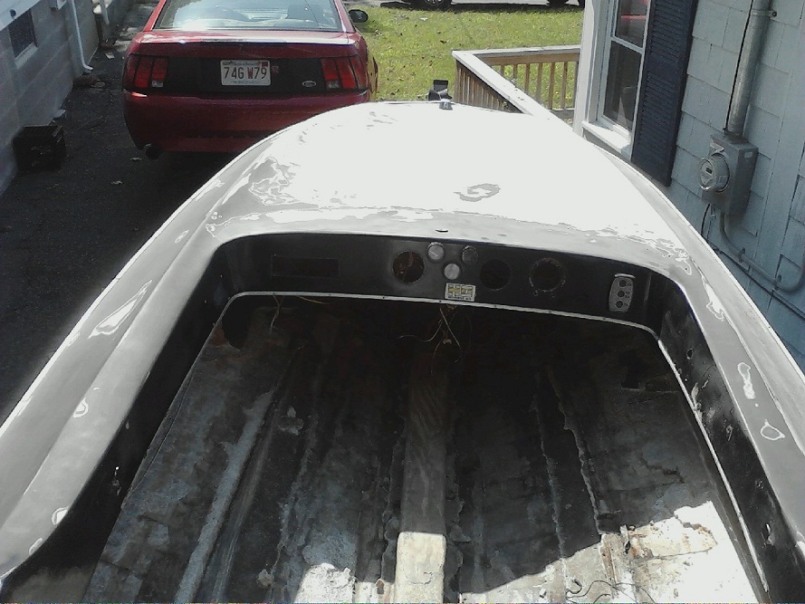

did a little work here and there. cleaned it up a bunch to see the core mostly out. i did post this for sale and these pics are mainly for the people interested
