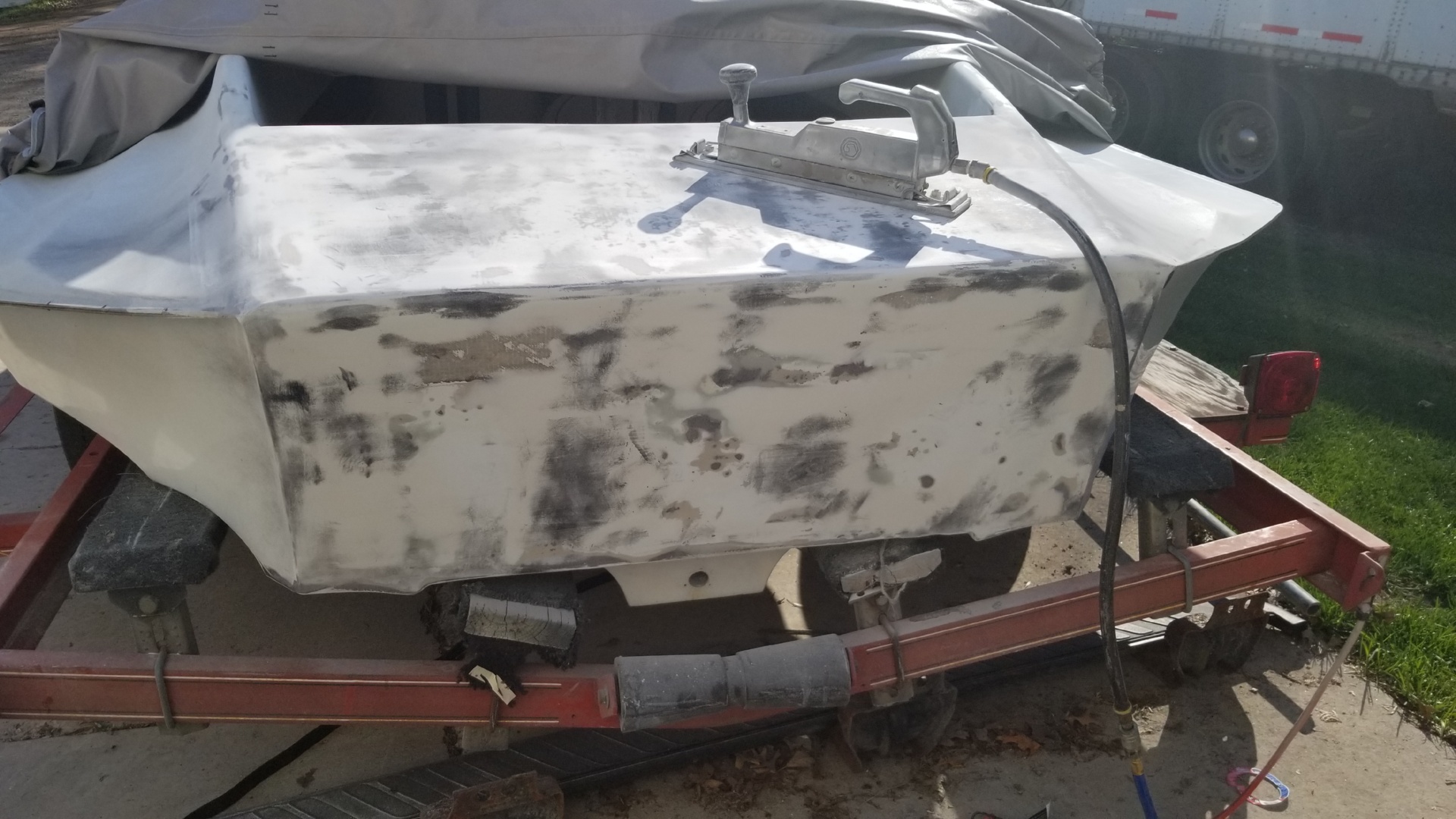

Picked up some resin filler from the guys at Express Composites and went to town on the spashwell and transom area. Not the greatest most interesting pics but you get the idea. This is after the second round of filler. The one corner I had to build up pretty good. Hopefully by next weekend there should be some paint on the back to make it not looks so trashy then the jack plate can go on.
I did put down a bunch of filler, sanded until my arms hurt (This stuff dries ROCK hard so its like trying to sand a rock), then laid down a bunch more filler. Its only temporary so I can go boating this year. Hopefully I can save up for a new paint job for next year.

Not a huge update but I did do a bunch of sanding yesterday. Its far from perfect but its good enough for me for now and ready to put some paint on it.
