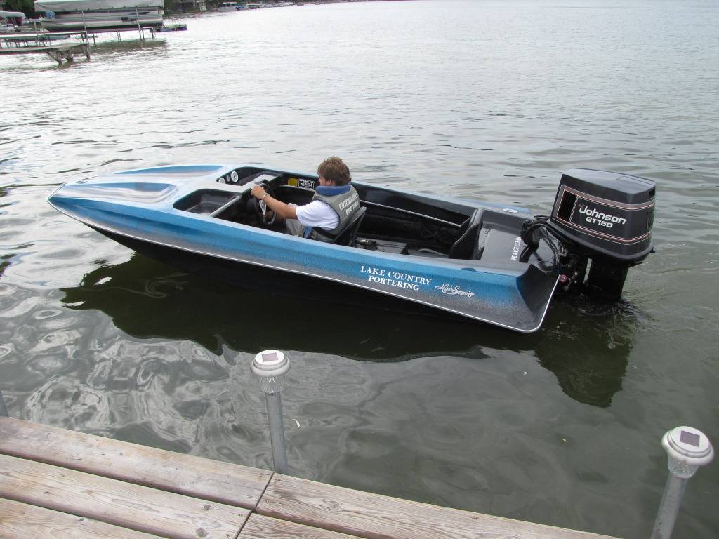

Post: # 19612Post bruzercomp81 »
This was right after we first hung the v6 on it.

Post: # 19615Post Hippie459MN »
Seeing that boat never gets old. That top picture I think is the only one I have seen of it without a lot of air under it. :mrgreen:

Re: 1978 Vandal Project
Post: # 19616Post Hydromirk »
Thanks bruzercomp that vandal is really nice and clean want mine to look like that some day :up:
