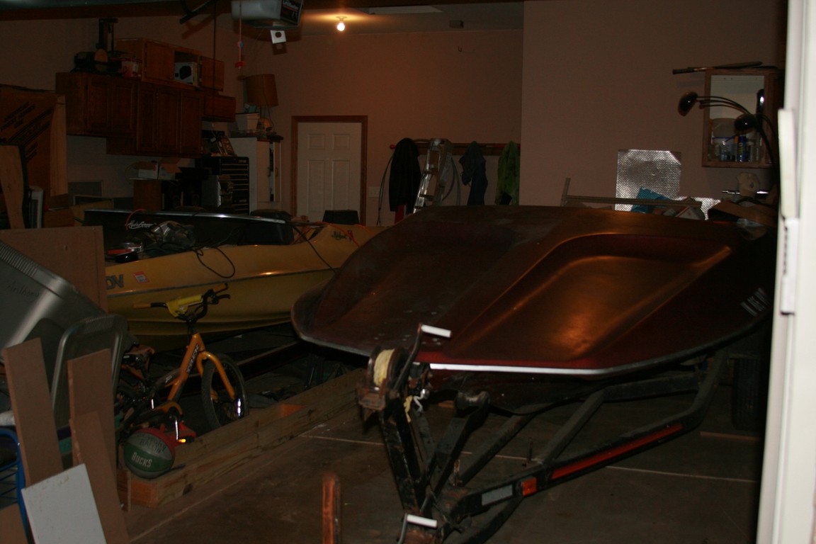

VultureNo2 wrote:I really like the looks of them. Bill
Already had this in the works but it wasn't a final deal yet.
:o
Picture 011 (Copy).jpg (132.09 KiB) Viewed 3690 times
Re: restoring a Ventura II
Post: # 18132Post Hippie459MN »
You got another stream? Sweet! :up:
Post: # 18134Post VultureNo2 »
Finally. I don't want to jack nosboss's thread. Catch me in the lounge. Bill

Yeah thanks, 9 hours round trip, but the price was right. It sat in a barn in Fort Wayne IN for the last 12 years. Bill
