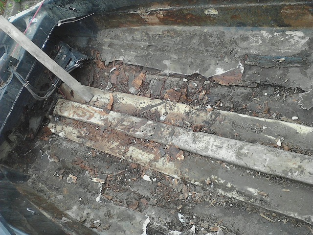

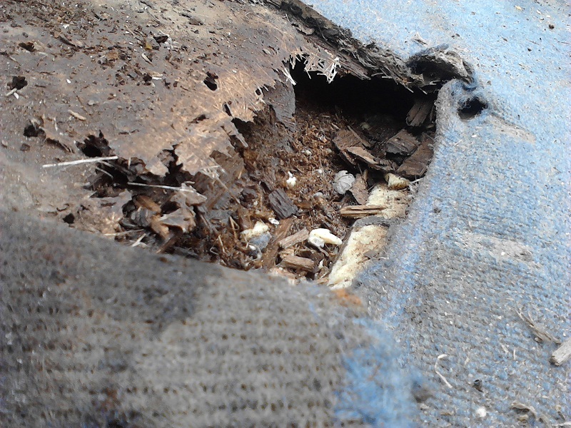

here is two pics of many i took of the boat. pulled stuff out for an hour today while the rain had stopped..
- hydro after one hour 3.jpg (175.04 KiB) Viewed 8243 times
- hydro under driver 3.jpg (250.85 KiB) Viewed 8243 times
looks nice and rotten makes for an easier tear down.
