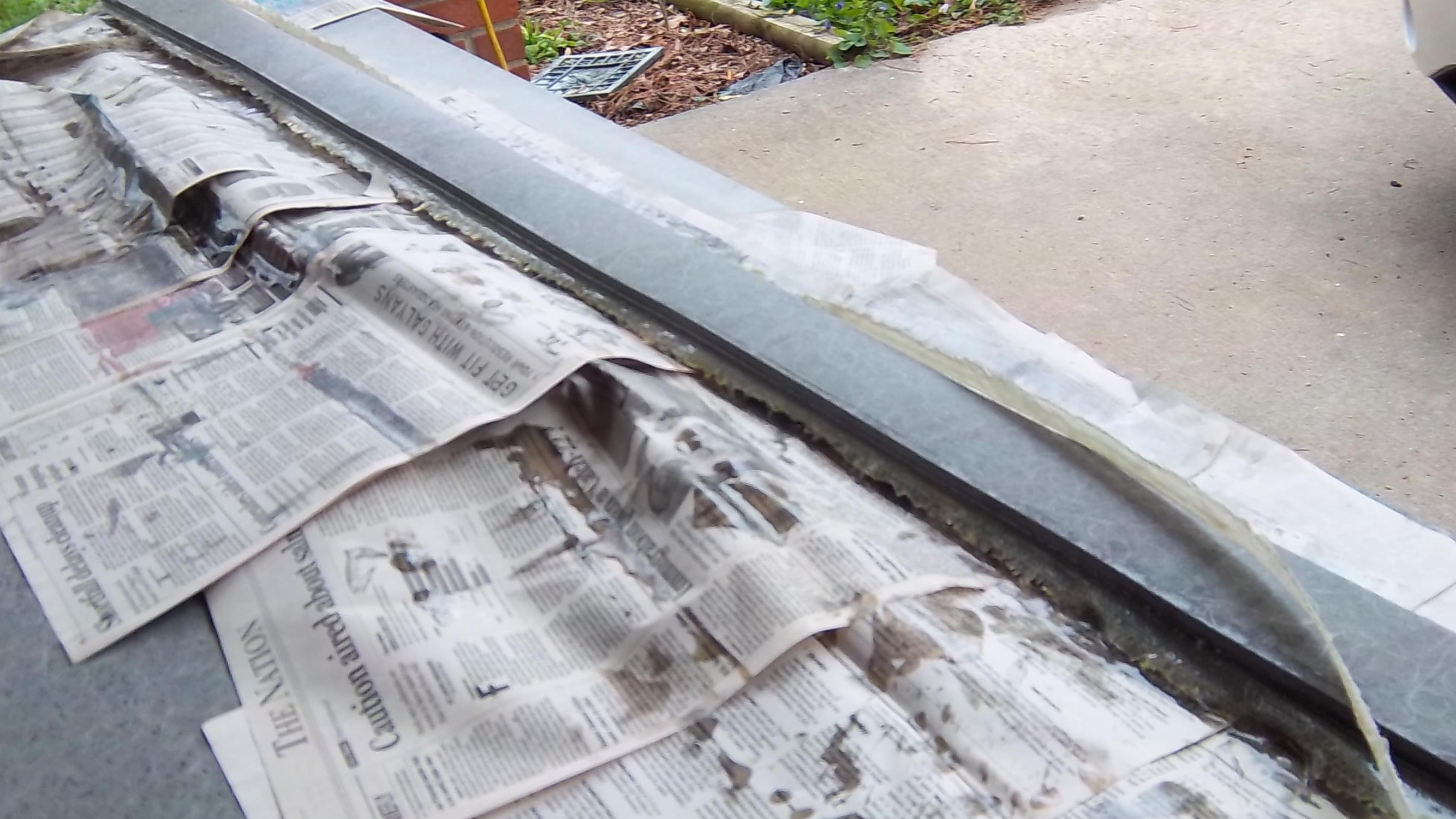

After many moons I got a chance to work on the Vector. I wanted to use coosa for the stringers but not sure now that I cut the stringers. Being only 3 inches tall a single 1/2 inch board is not very rigid. Wanting to stick to my plan I laminated two pieces together using two layers of 1708. This helped, but i still have my doubts. Maybe when they are glassed in and floor added on top I will feel better about them. I will hate it if I have to tear them out and start over.I am going to cut a 3 inch strip of plywood today and compare.
Tryed to load pics but ran out of time, gotta go to work, will get it done after work.

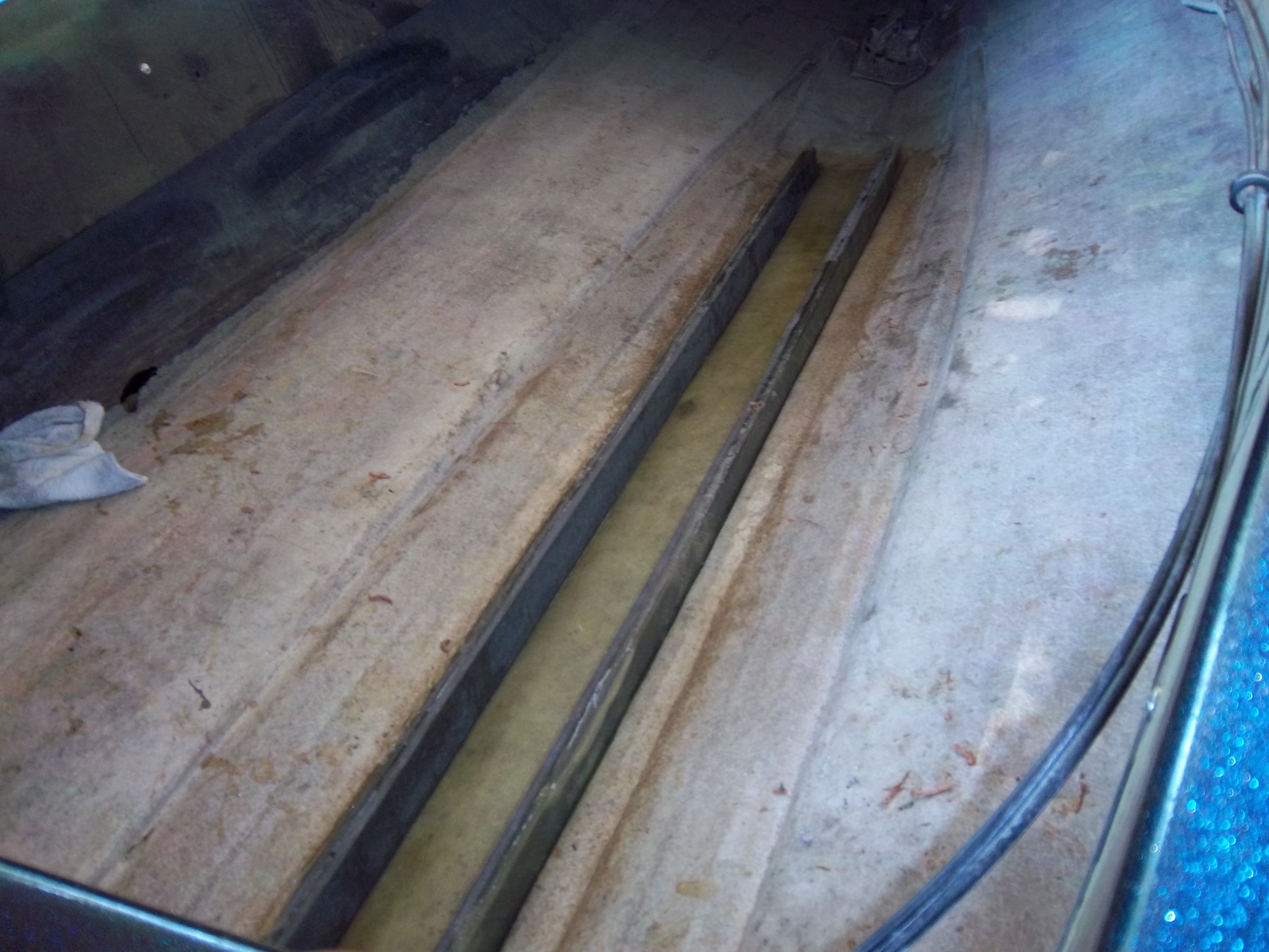

After a month of running the roads chasing a dollar I have a few days to make progress on the vector.
Got the stringers sunk into two layers of 1708 laid on the pad and up the the outside edge of stringers.
It took alot of fitting and trimming to get them to stand up on the concave pad. I don't know how I loaded the pic twice.
