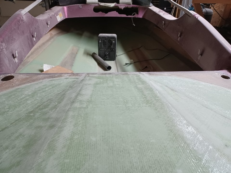

the splashwell delete is something I haven't been impressed with on a few builds, specificlally raised transoms. considering this is a raised transom, I spent extra time trying to make something different.

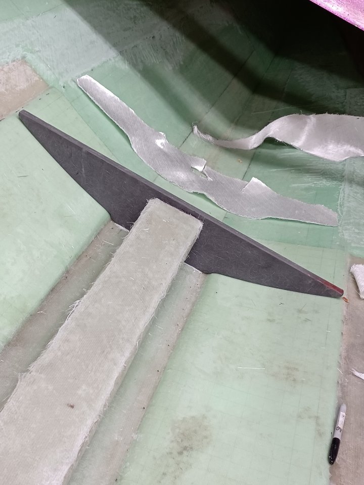

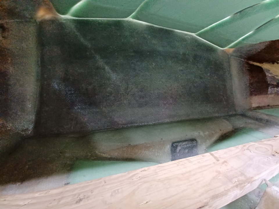

stringer box was ground down do remove some sloppy glass work. then reinstalled similar to factory. the variable is the stringer is now on top of core, when originally the stringer went to the bottom skin.

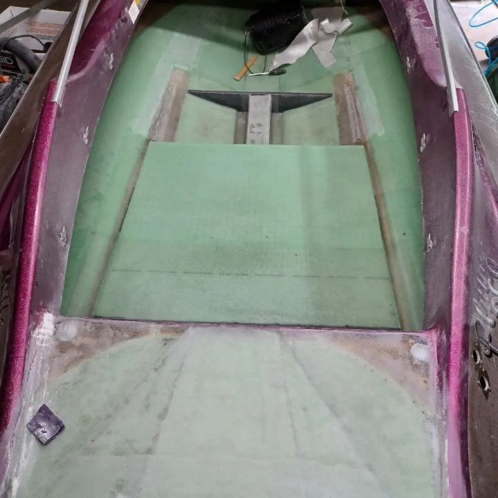

floor going in and engine on

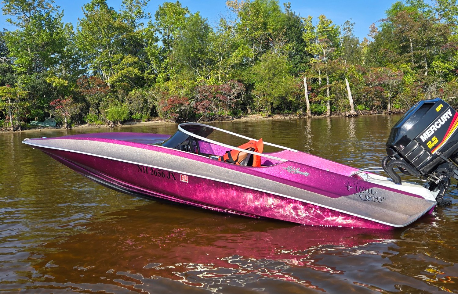

Shes running now, and it feels like a race boat
