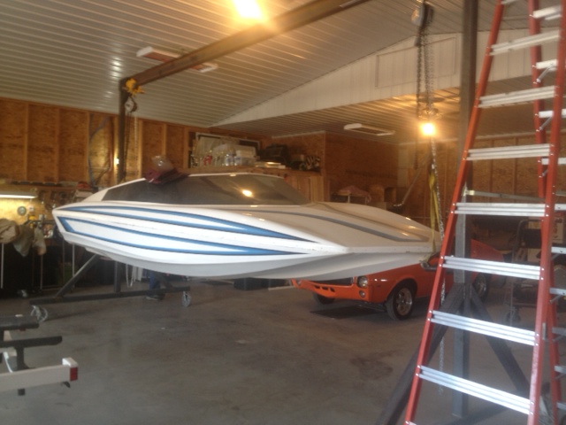

I made a rotisserie for the Virage and cut down the transom for a 15" motor. Took out the splash well and made a mold for the new design rear deck. :up:
Saving pictures for a full write up when done.

Very cool Ron! Just a question, why go through the trouble of cutting down the transom on something that easily handles a 20" motor? I could see an advantage on a smaller boat to lower the motor's cg, but why in this case?

I am running a 15" motor.
Alby Pine has the same setup with a standard height transom and has no reported problems.
Aaron Wacholz (Black boat pictured) wanted his cut down.
I decided to cut mine down because I liked the look of Aarons. Those extra lines in the back add a lot of strength and some "texture" to an otherwise flat rear deck.
Look at the rigging hoses in this pict. I think if you wanted to be able to trim up without jacking the motor up all the way, you would kink your cables...

Makes sense if you already have a 15" motor for sure. I get the strength reasoning too. I have yet to see one of these hulls in person. There's one in Ottawa I hope to see next year, these are my favourite 'streams.
