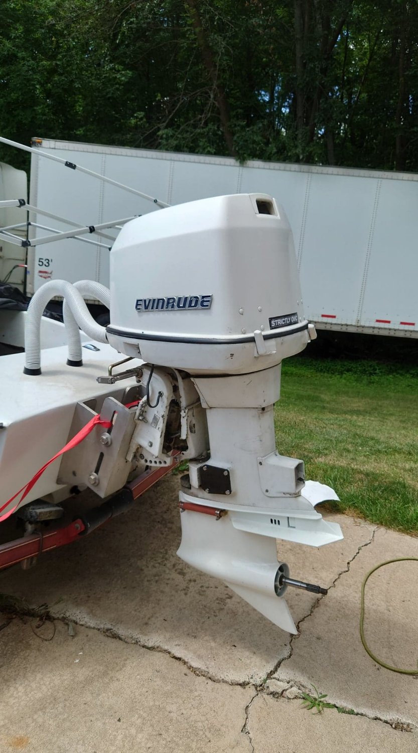

Set back is the jack plate that bolts to the transom that you bolt the motor too. As for not having a cone on the lower, raise the motor up as high as you can without loosing water pressure. Blocking off the top one or two water intake holes on the lower can also help get it up higher without loosing water pressure. And get that steering tightened up and solid motor mounts will be your friend. No one said going fast was cheap or easy. lol
As you can see, my Vulture has a 10 inch plate on it. I might go to a 12 inch but not sure yet. These vultures LOVE the set back due to the cockpit being so far forward on them.
