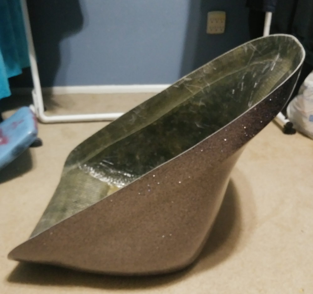

:up: Going to fab up a console like this very clean...
"Rollin Hott Texas Strong" :up:
Re: Hydrostream "Blue Angel" Vking Resto
Post: # 23701Post Hippie459MN »
Where did you get the seat shell and how much was it?
Post: # 23702Post Shortblock »
300$$ for the set shipped from a guy in Tennessee...
Post: # 23703Post Hippie459MN »
Did you get covers with them also?
Post: # 23704Post Shortblock »
No just the seats...

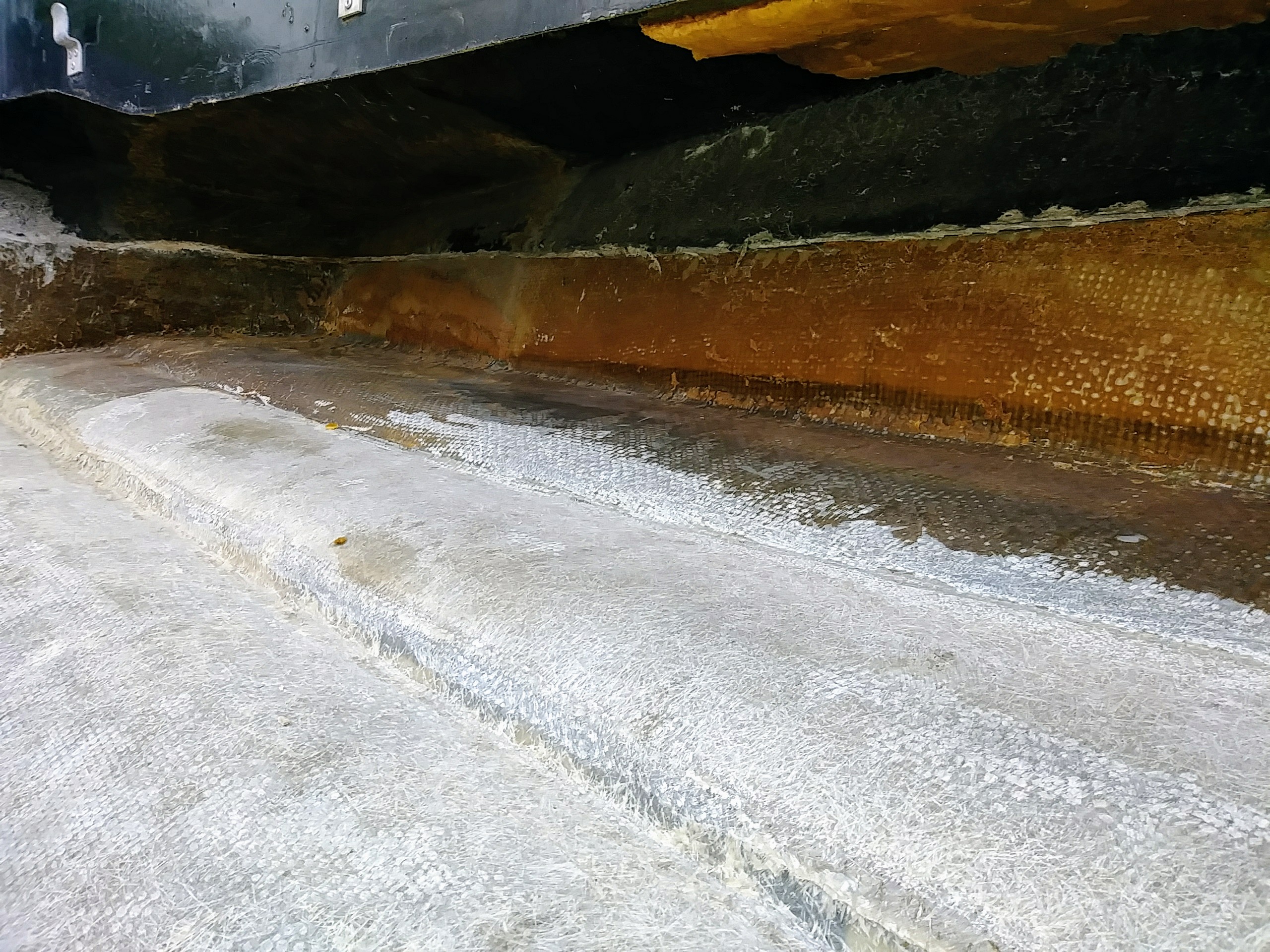

Post: # 23705Post Shortblock »
:up: Hey guys when grinding on the inside of your boat one way to gauge how much grinding left you may be able to do is wait till it gets dark outside with a LED white flashlight shine it on the inside of the boat hull after wetting it down with water avoid the transparent spots where you can see the gelcoat.... Hopefully this helps someone...
Post: # 24197Post Shortblock »
:up: More foam fellas!!! From under the top cap still itching.......
Post: # 24198Post Hippie459MN »
Its amazing how much foam there is when you start cutting it out. lol
