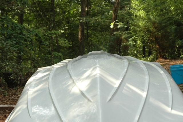

I recently prayed my Viper with white gel coat mixed 50/50 with the Duratec gel coat addative. I used a 2.2mm tip with a HVLP gun I purchased at Harbor Freight. This was my first real experience with spraying. It came out quite well. The Duratec additive thinned it down and allowed the gel to "flow." Any areas of orange peel was due to my inexperience. It took a little bit of work with wet sanding and buffing, but nothing like what it would take if it was straight gel (without the Duratec).
If I had to do it again I would use the same set-up, although I would put it on a bit thicker. I got a little thin in areas. I'll try to attach a picture.
