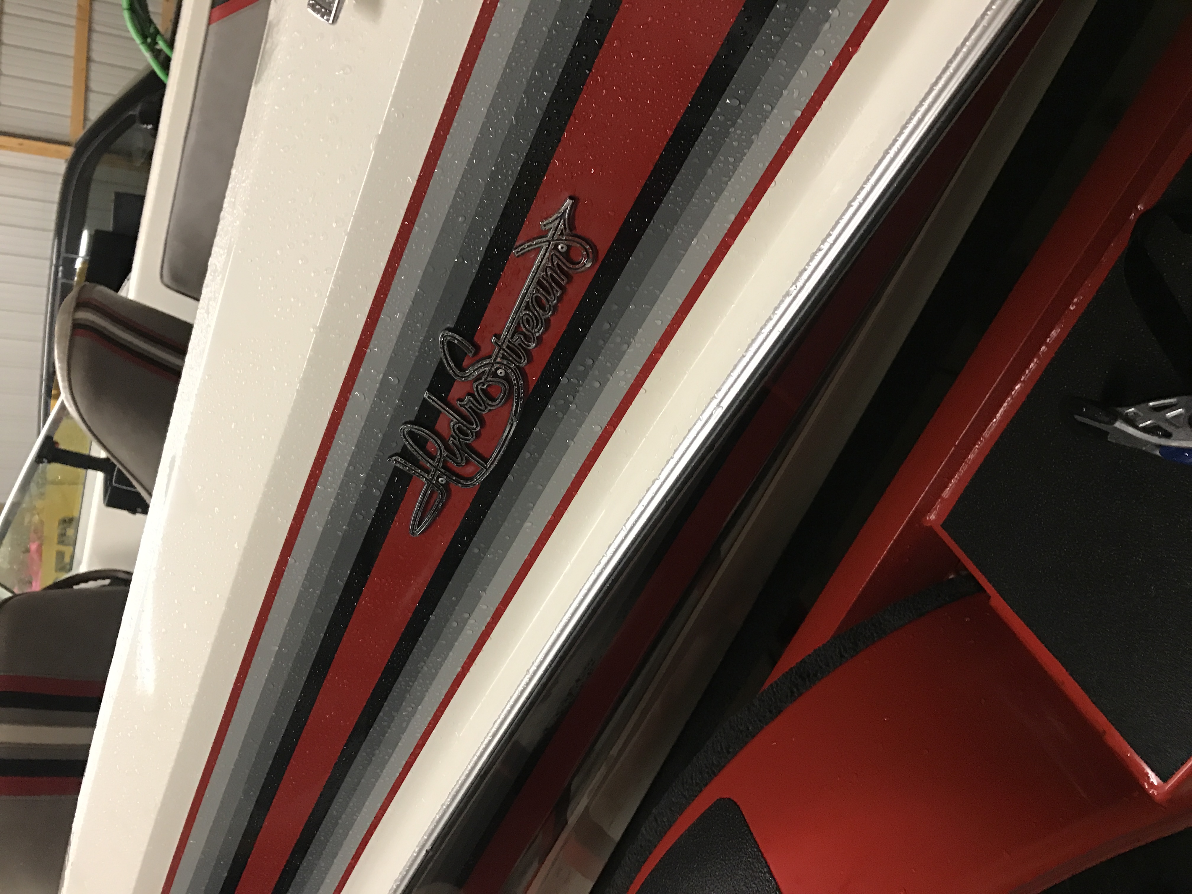

Hey guys new to this site. I currently own an 87 Valero that I found in Georgia. Bought it off the original owner which was about 80 years old believe it or not. Has a 175 blackmax the boat is so clean you can eat off of it. He said he ran it maybe a total of 8 times ever. It was garage kept its 100 percent original. Original trailer with original tires I have all the paperwork from the dealership down to the deposit slips. Warranty slips on boat motor trailer all that crazy stuff. I have the original center windshield as well. Seats carpet gel are perfect not a single crack anywhere. she really is a time capsule and literally looks like the day she did when she was built the leather is still soft in the interior. I've ran her all last summer boat takes on zero water ever. My question is the core. Everyone seems to have a problem, but being such a rare find with no time on her at all do you think it's even an issue to consider? The boat never sat in the water and he said it had under 60 hours on it total.... now off to my next question my buddy has an 84 vector we are going to do the core on before it's painted. Never done one before any tips or pointers would help out a lot were hanging a 150 black max on it with a jackplate and hydraulic steering
